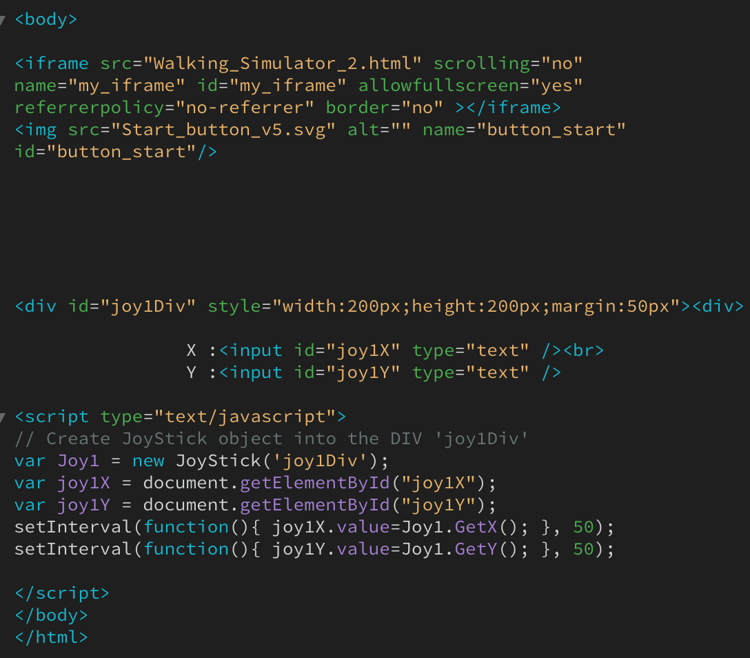

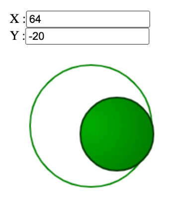

    i want to embed a virtual HTML5 joystick. The structure looks like this:

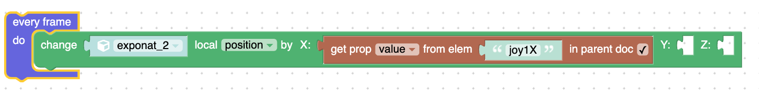

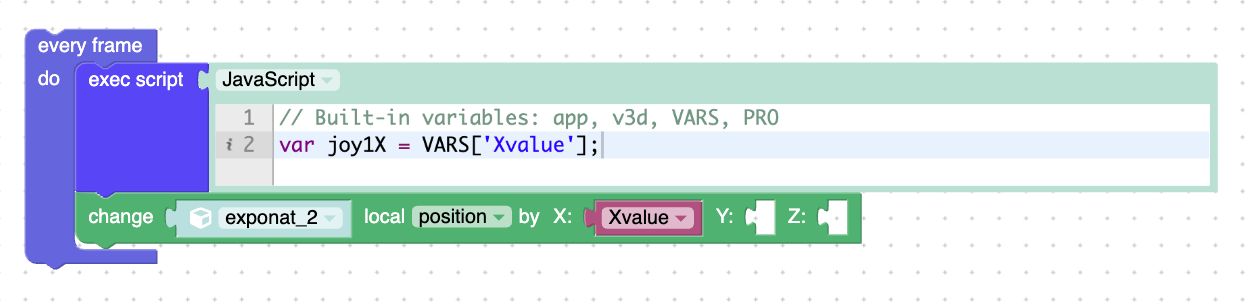

    Verge3D Object is embedded via iframe. The controller is embedded as an external Java script. Controller and Controller values ​​can be displayed, but I have no idea how to get this value into the puzzles to control objects. I attached the HTML code and my previous puzzle attempts .. does anyone have an idea?
    #38598
    right, you can use either of the methods you pictured. Doesn’t it work? Can you print to console the values that are output, to confirm those are actually the numbers you expect?
