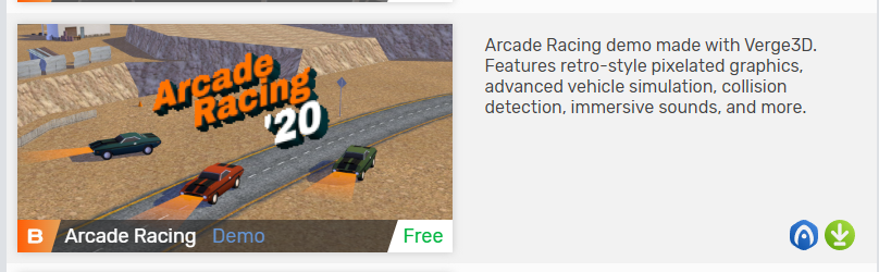

    #66544
    Downdload this demo
    and look through its puzzles
    #66626
    c4cc
    I’ve seen this, but he uses javascript to move around his vehicle around. On the other hand, my character is a series of objects, each with its own keyframe. So how do I change position of this character without messing up the position of each individual object, thus preventing the character being messed up?
