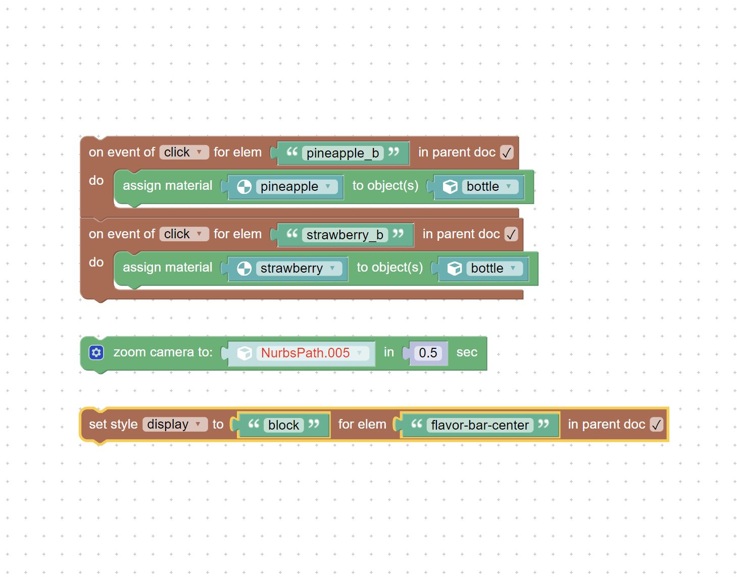

    Hello i have been trying to set the icons on and off at loading but I cant seem to make it work. On the html I have the div set to non and then on the puzzle i set it to block but it wont work. I’m calling the Id on the puzzle but nothing. I don’t know what to do?

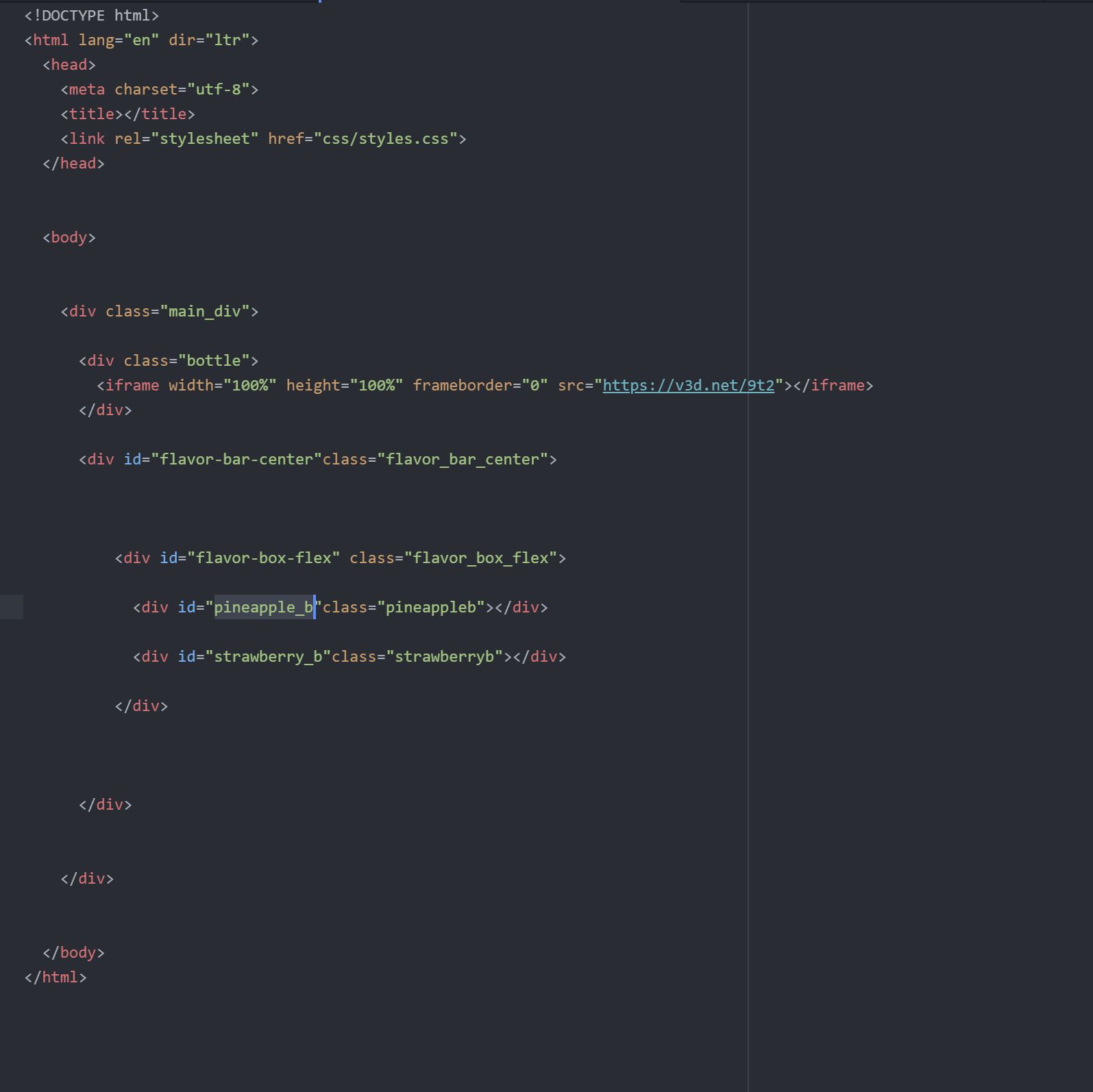

    I send the working files to soft8 info email and to KdV email. Im also attaching some screenshots of my puzzle / html and css file. Thank you guys for helping me, im literally going crazy lol. i cant figure it out
    #54781
    visual_logic.js doesn’t work at all in your app because you have a wrong iframe src in index.html
    <iframe width="100%" height="100%" frameborder="0" src="https://v3d.net/9t2"></iframe>
    Change https://v3d.net/9t2 to Natural_Amino_2.0.html
    <iframe width="100%" height="100%" frameborder="0" src="Natural_Amino_2.0.html"></iframe>
