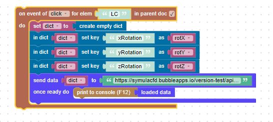

    I’m struggling with the send data puzzle. I’m trying to do a post request to a website in bubble.io (aws s3 would be fine as well) but I keep getting bad request error. In my puzzle I read three inputs, store them in a dict and send them as data in the puzzle to my website url. I also tried hardcoding in the visuallogic.js code my authorization key as header of the request but same error. How can I do to send the data?

    these puzzles look good to me. How does the script that receives the data on the server look like?
