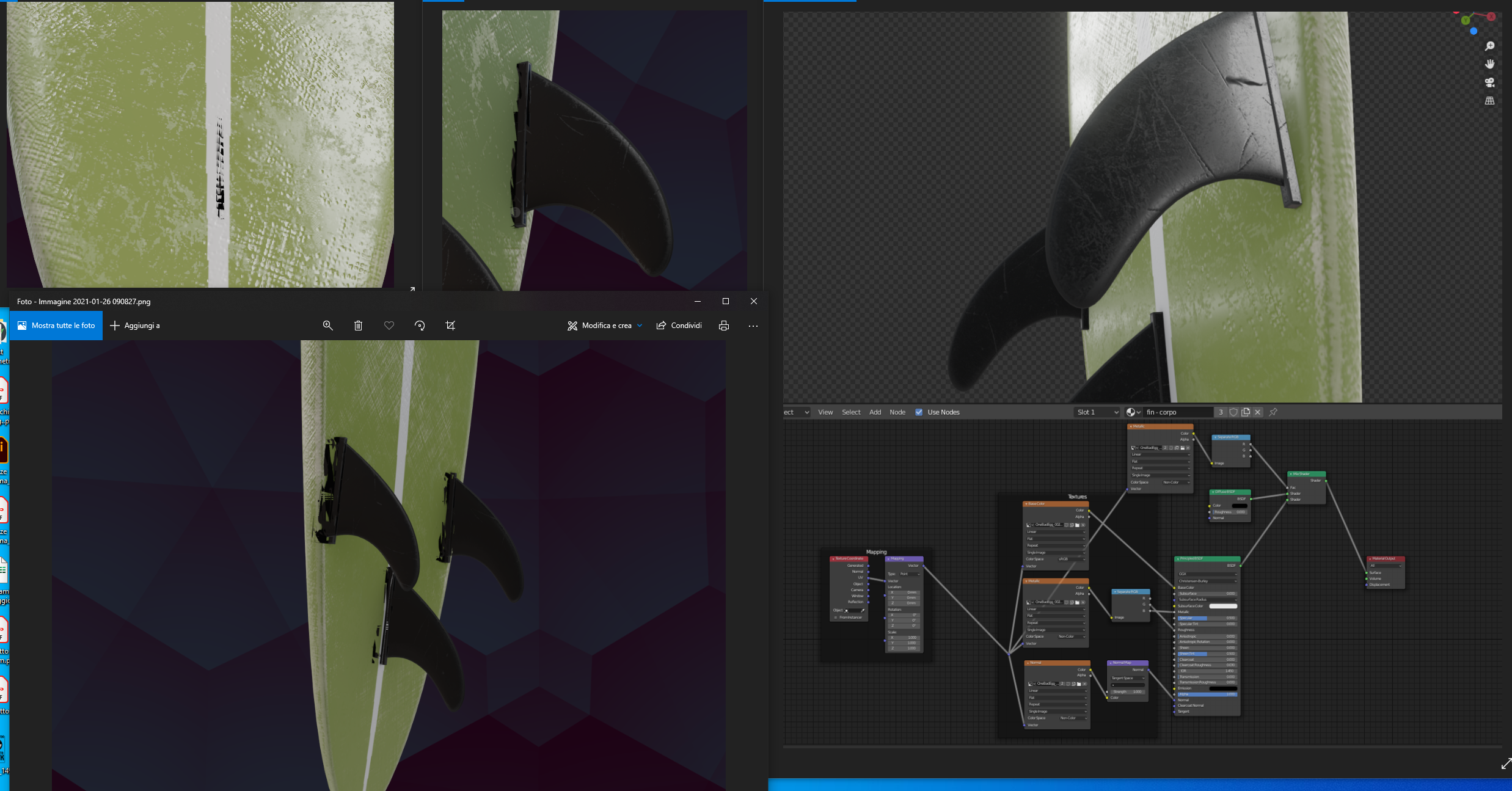

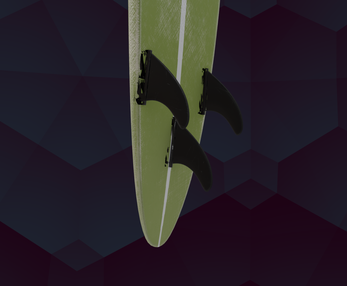

    I hope that some can help me understand why i’m getting the visualization issue that i attach.
    In blender thaere are no errors. Textures are exported from Substance Painter in ORM + base color + normal OpenGL. I used the R occlusion channel as AO input as the other image attached.
    Any idea on what can be?
    Thanks in advance :)

    I find out that depends by the Camera Clip, the start value.
    How i can avoid the issue and set a value lower enough to zoom to the surfaces without clipping?
    Thanks

    This looks like a z-fighting issue. Yes, you can reduce the Clip End and/or rise the Clip Start value for your camera.

    Ciao Yuri and compliments for your project! I setted 0,3mm and the defect is reduced when the camera is far away. Is that the only or right way?

    you might also try reducing Clip End!
