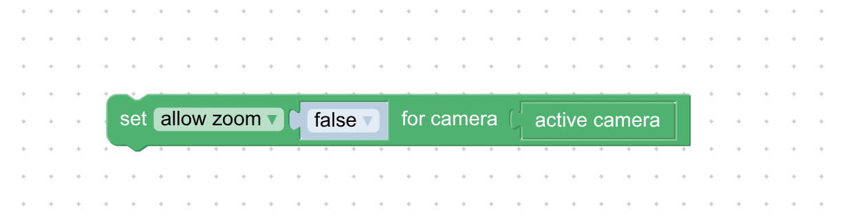

    And can a orbit Camera please allow the scroll event because I have some use cases for the user being able to orbit an object but instead of zooming I would love to funnel it into scrolling?
    Sure, just disable zooming for the active camera by setting its “allow zoom” param to “false” (with set camera param puzzle).
