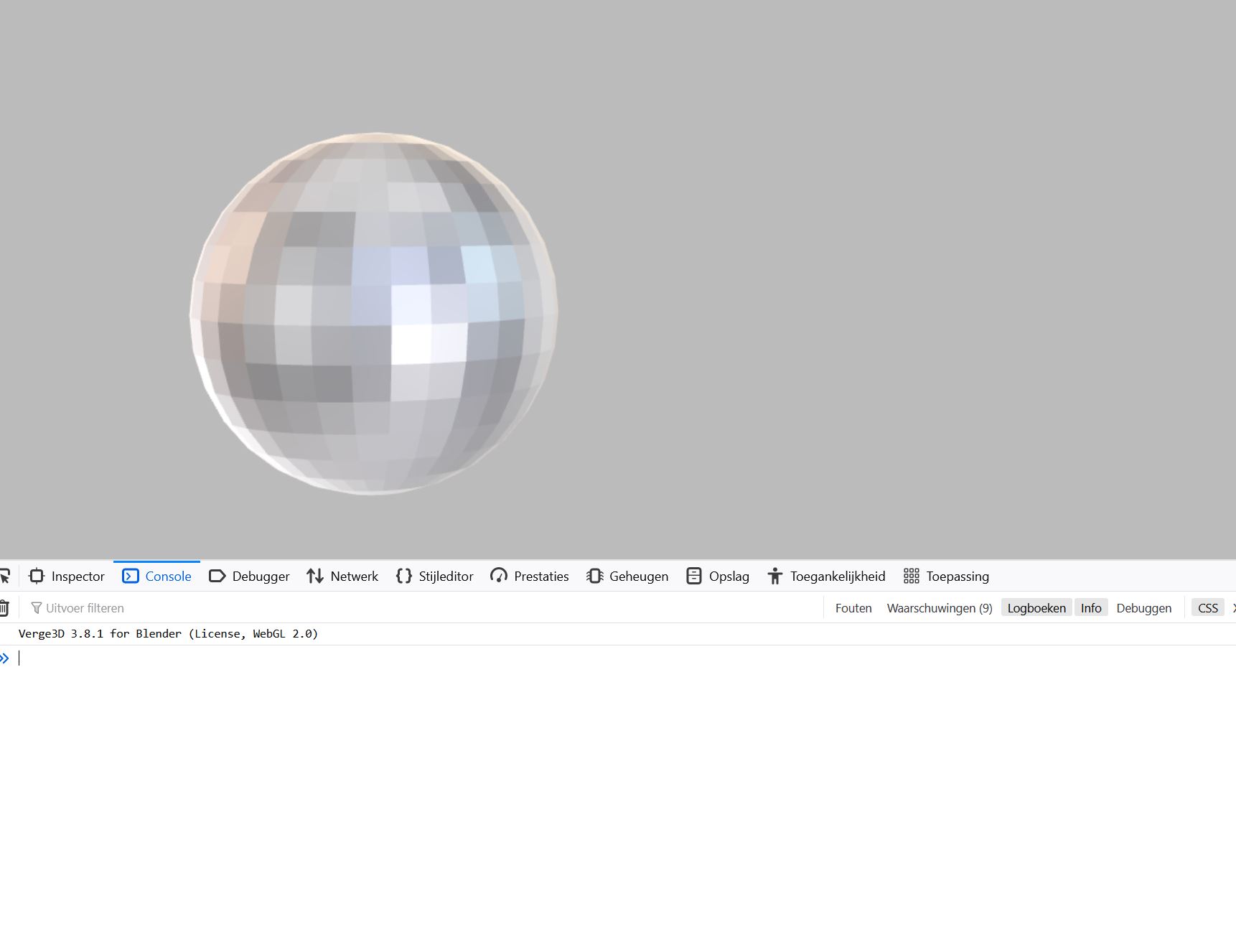

    I am making a scroll animation according to the soft8soft tutorial.
    It is a ball moving from left to right, just to start basic.
    Do you have to always bake all your object animations for export to verge3D?
    It seems that the step where the console is showing data when scrolling is not working in my setup. Is the map range puzzle working I wonder?
    And the animation is not playing either, but I think this is because of the absence of scrolling data.
    below attached my puzzles and console.
    Any help is welcome.
    #46942
    try changing your onEvent from “container” to “window”.
