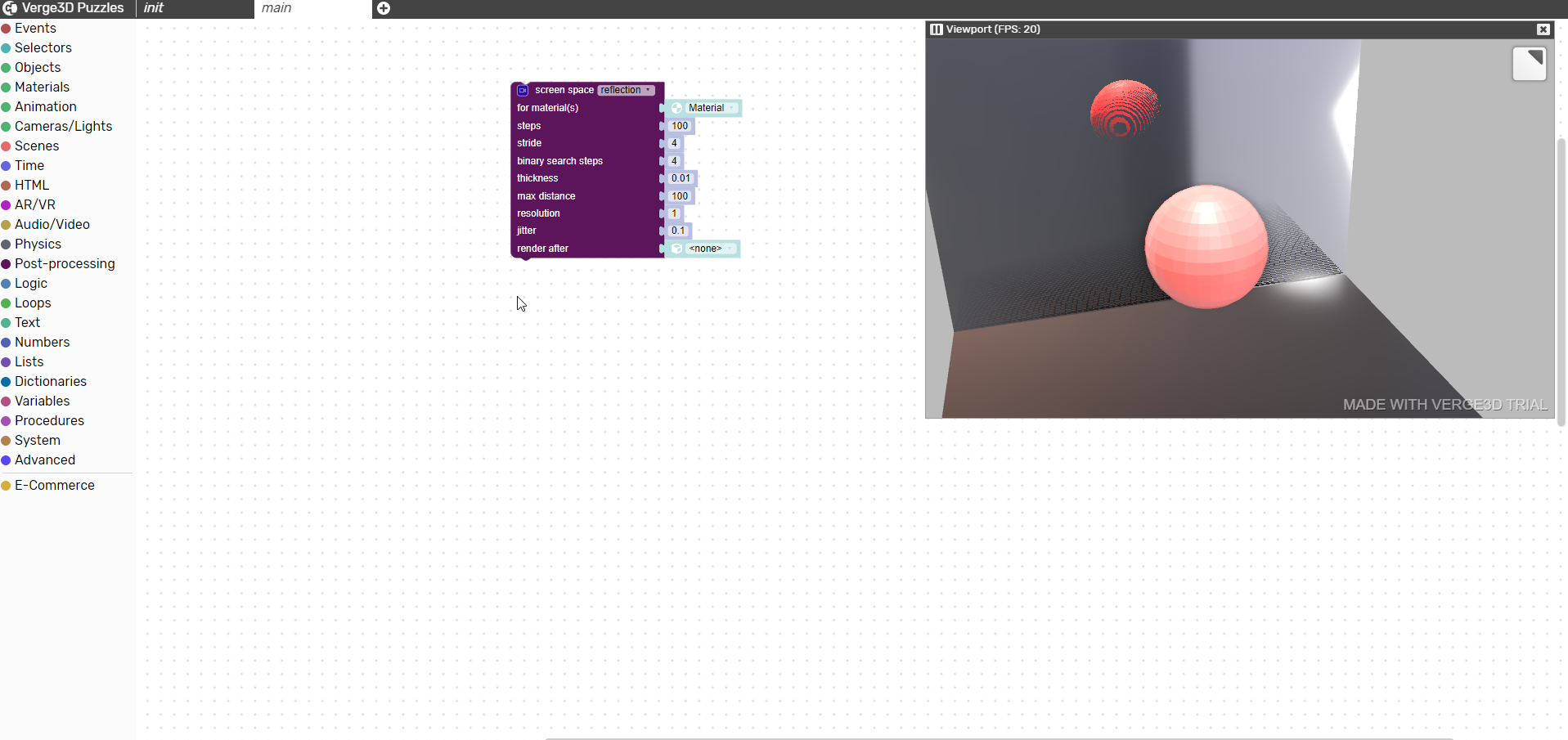

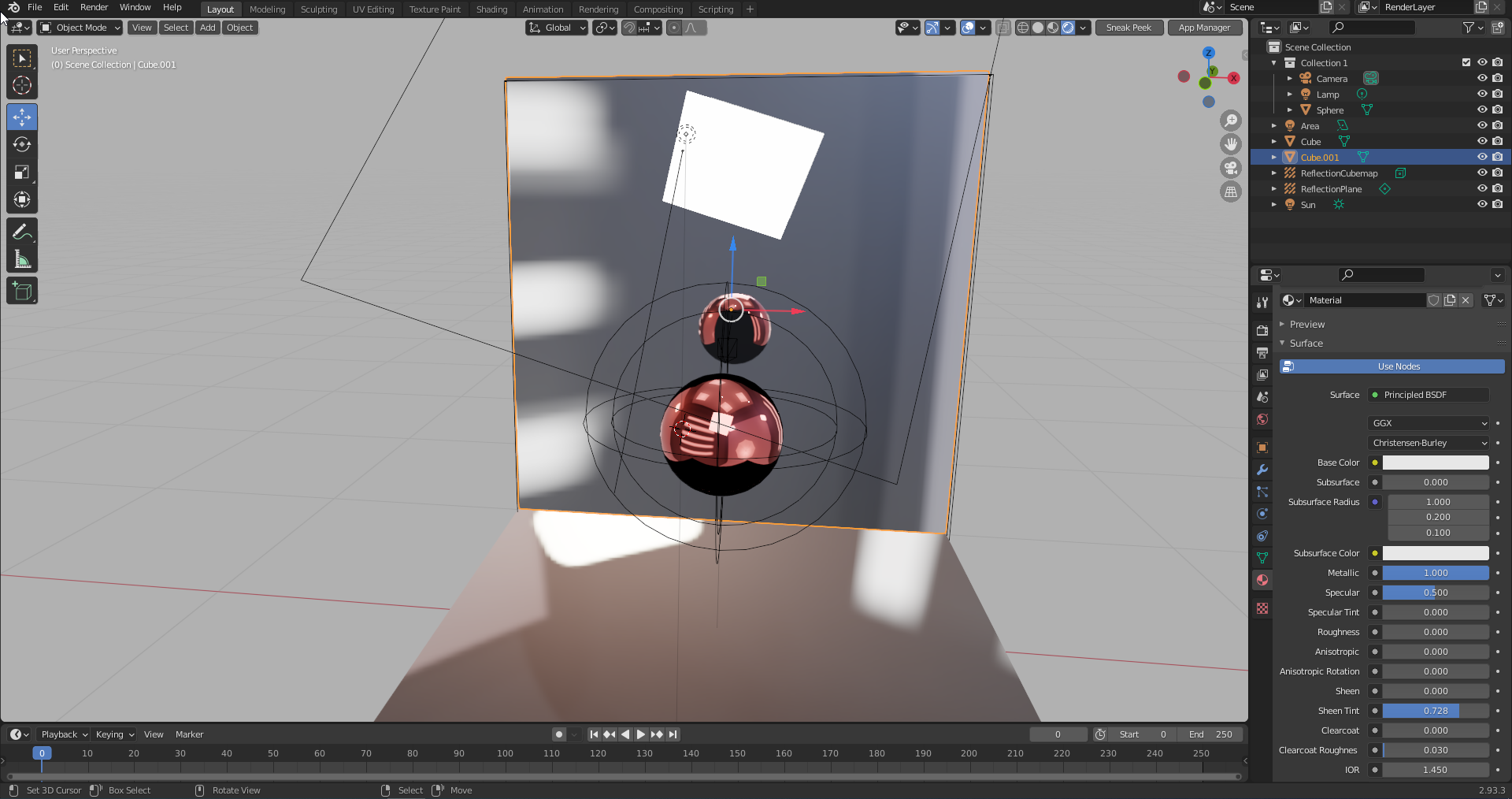

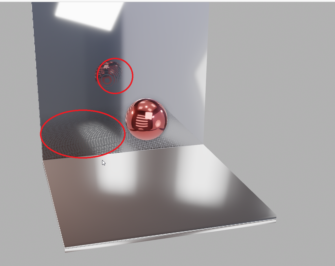

    I tried to make a mirror to reflect an object and I used SSR puzzle but the result is like in the attached photo. Do I have to make any modification in Blender to looks better, not just some lines reflected?
    Thank you!

    Unfortunally SSR in the engine works much worser that in Blender, try to use reflection plane instad.
