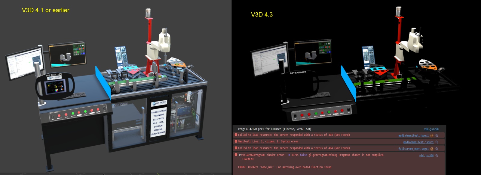

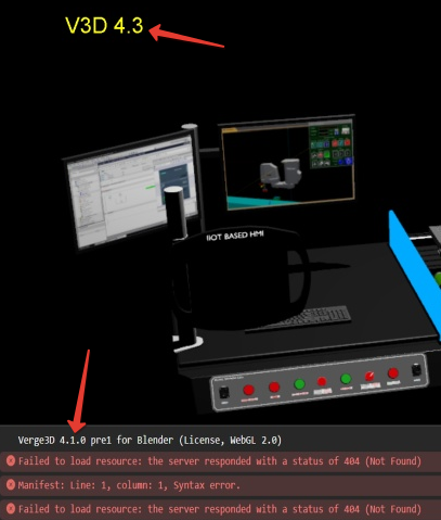

    I had created a scene with verge 4.1 and later I transferred it to 4.3. After publishing it from 4.3 I see al dark light & I get this console error as shown in image.
    Is there easy way fix OR I have to transfer all scene with puzzles editors to new version?

    Yes KDV I think it was 4.1 not 4.3 .
    #68049
    Looks like you re-exported your scene with the new plugin and maybe even re-saved puzzles, but you didn’t update v3d.js in the app’s folder…
    #68369
    visualizer
    Yes ! I thought it will automatically publish it with newer version. updated it manually and now working ok.
