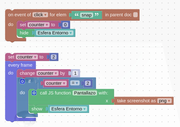

In fact I got it working after changing the counter comparison number to 2:

The only thing now, is that the button make the snapshot only first time :-S
Do you notice it?
Yep! I managed to fix that as follows:

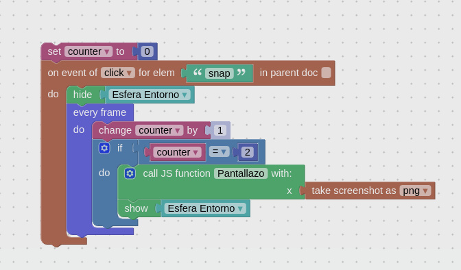

Yuri Kovelenov wrote: Yep! I managed to fix that as follows:
Almost fixed… The button is always working now, but only the first snapshot is transparent :-p

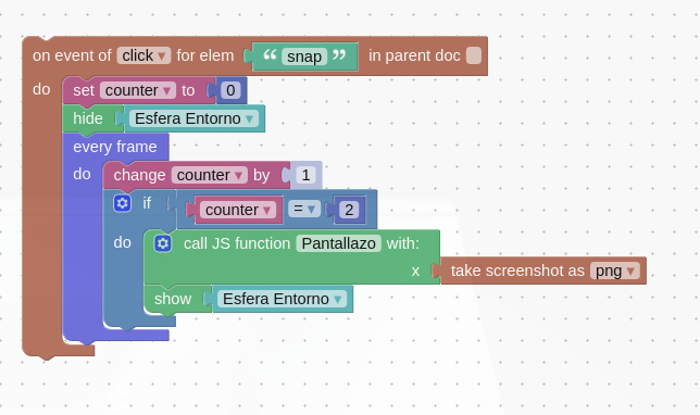

Oops… Try this one:
Yuri Kovelenov wrote: Oops… Try this one:
Wow, you’re the man! Thanks so much ^^
