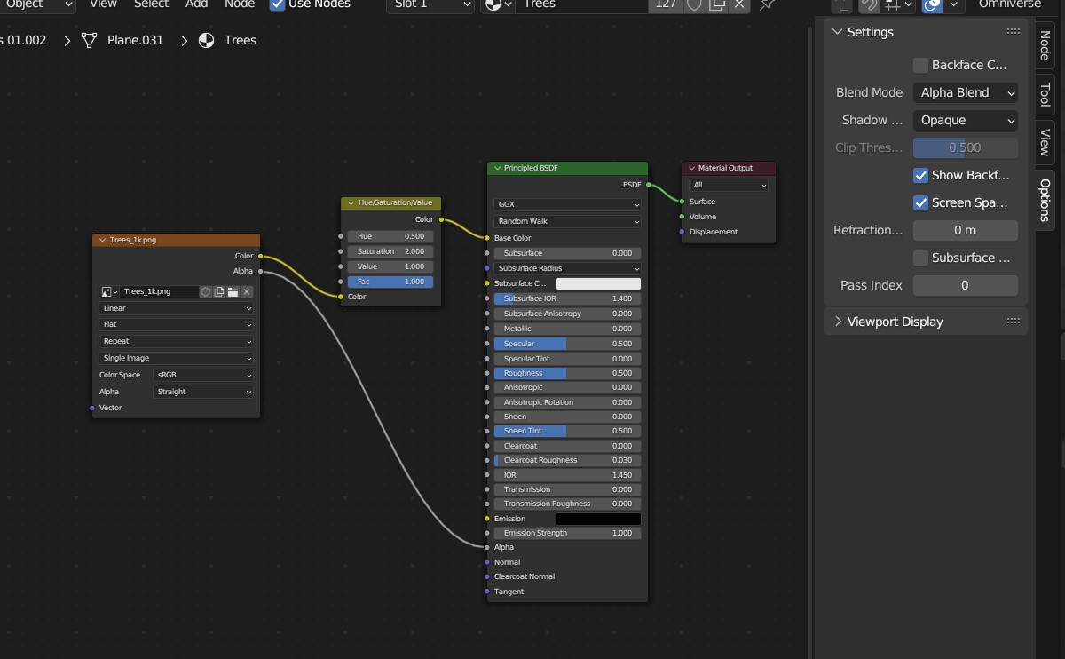

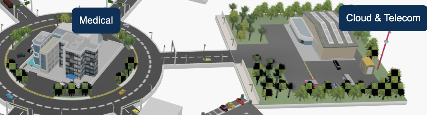

CustomerI’m experiencing a rendering issue in Safari with a scene that includes billboard trees. The problem occurs only when the trees are at a certain angle or depth from the camera. When this happens, the trees appear as black and transparent checkboxes.
– The issue is specific to Safari; other browsers render the scene correctly.
– The problem doesn’t occur when the camera is closer to the objects.I’ve tried various approaches to diagnose and fix the problem, including optimizing models, and experimenting with blending modes, but the issue persists.
Are there known compatibility issues or specific settings I should be aware of to handle this scenario in Verge3D? Any insights or suggestions would be greatly appreciated.

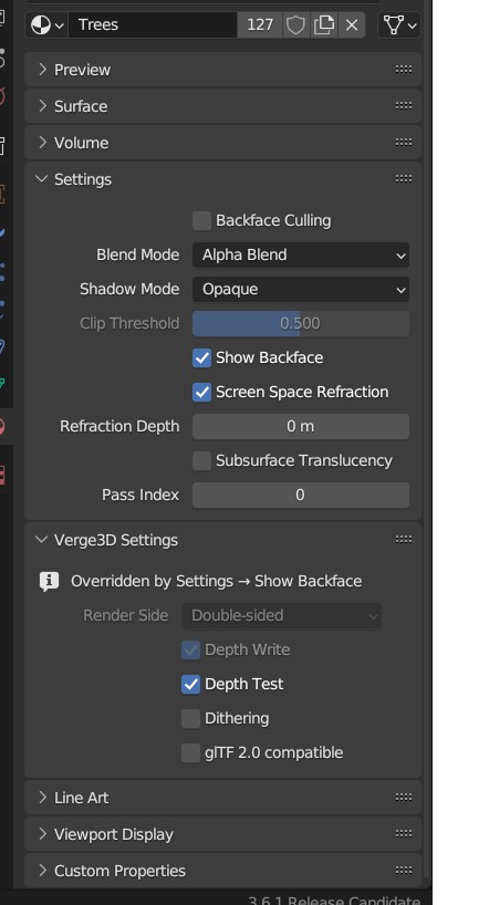

2023-08-10 at 11:48 am #65937metabaker
CustomerVerge3d settings

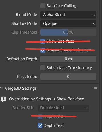

2023-08-10 at 11:53 am #65940kdv
ParticipantTry this way
2023-08-10 at 12:29 pm #65946metabaker
CustomerWell, this did not work, unfortunately.
If I set the blend mode to Alpha Clip, the trees are rendered on Safari without any glitches, but the quality is somewhat compromised.

2023-08-10 at 1:43 pm #65956metabaker
CustomerThe issue is on Macbook Pro. It works fine on iPhone and iPad.
Here’s a screen recording:
https://drive.google.com/drive/folders/1lHwGXxm7taHEWRCUJatTAKlrQ8-2AeXr?usp=drive_link
2023-08-10 at 1:44 pm #65957kdv
ParticipantDrivers issue most likely…
