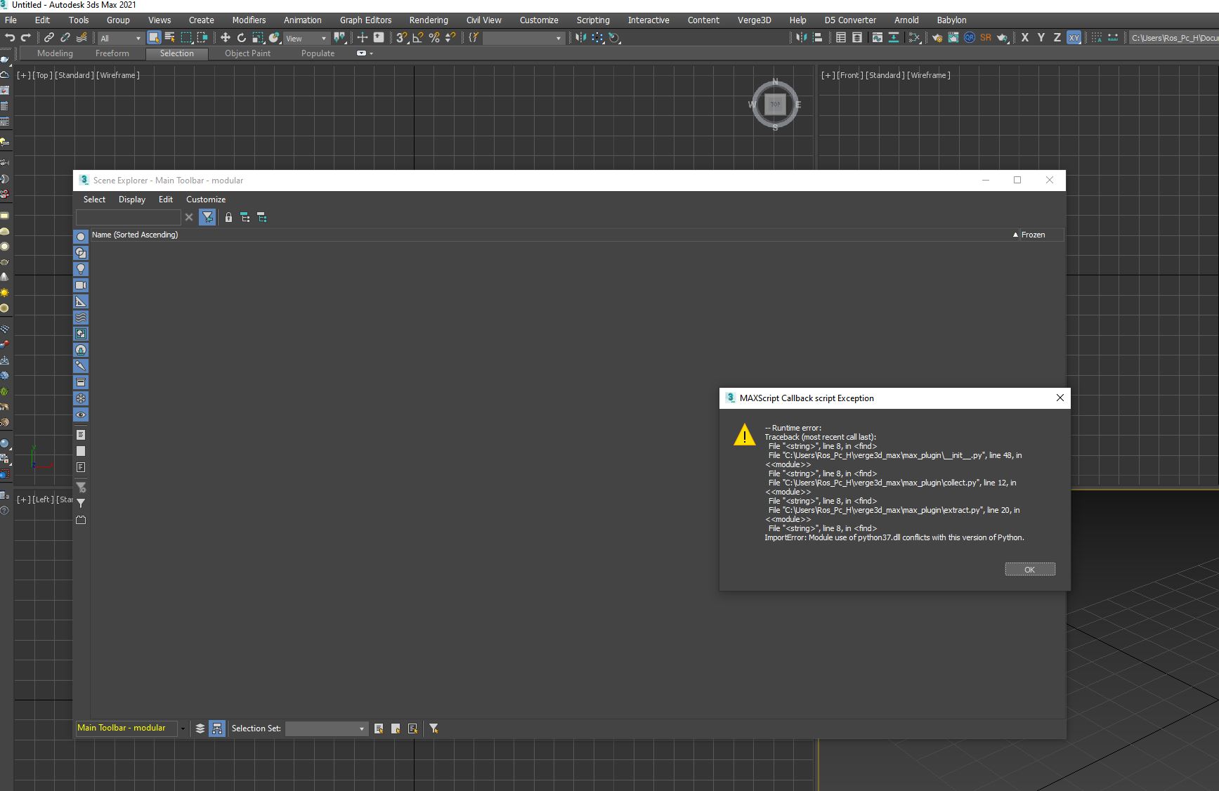

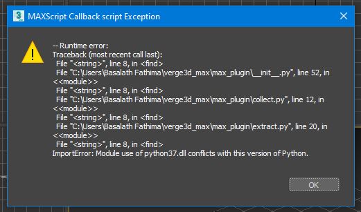

    I seem to get many runtime errors in 3DS Max 2021 after installing Verge3D 3.5.0. Please help me sort this issue.

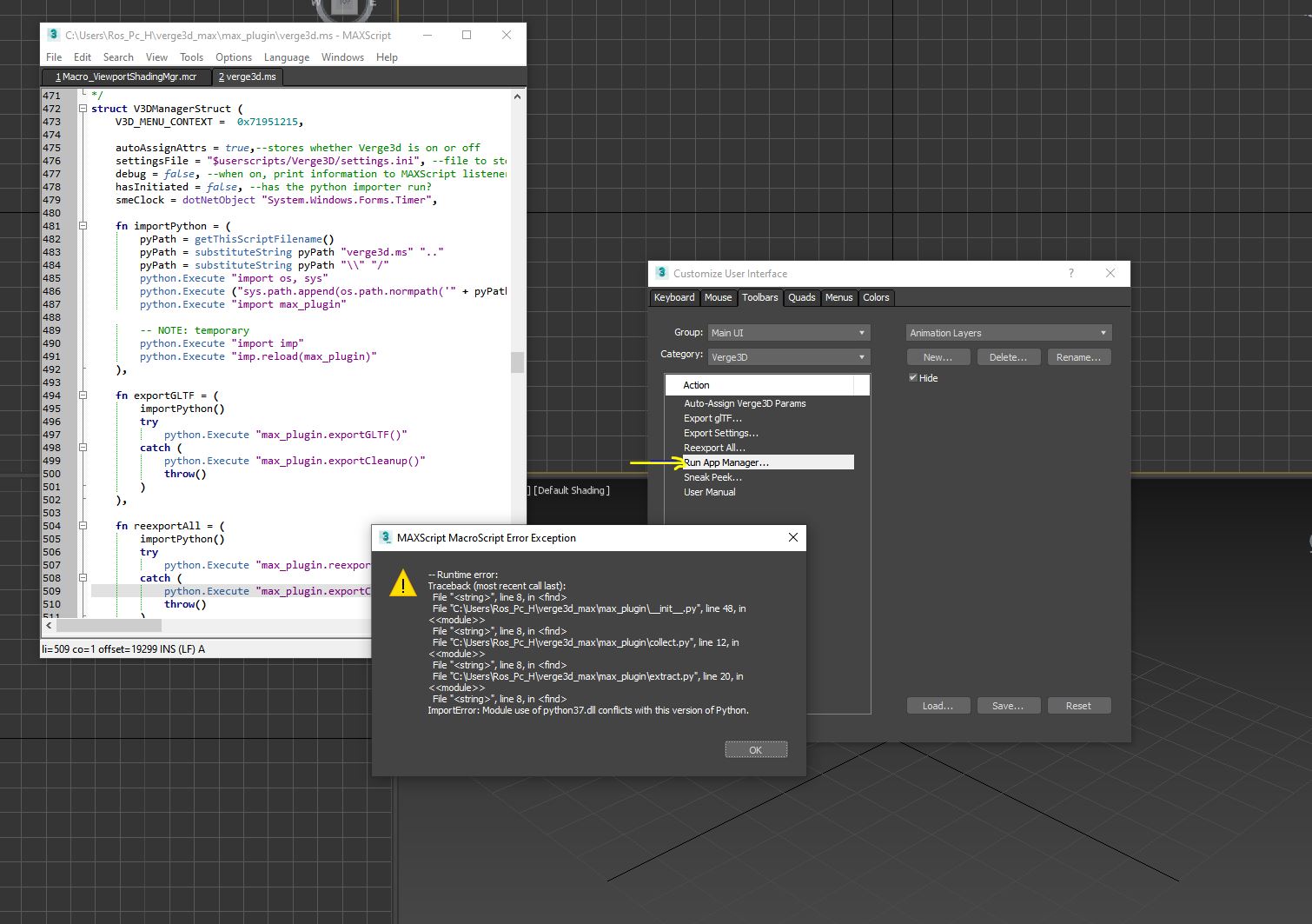

    In both my pc the new installer 3.5 gives me this error and the verge3d menu is not created.
    Even if I go “manually” to run the app manager I got this error.

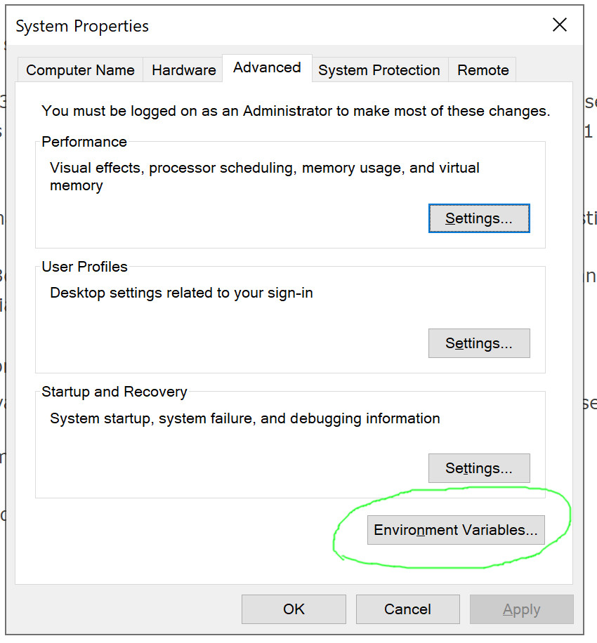

    It might be issue with some of the plugins, erroneously forcing older version of Python. To verify, please run System Properties dialog (search for “edit the system environment variables”), then click on the Environment Variables button.
    In the dialog, search for the ADSK_3DSMAX_PYTHON_VERSION variable. Do you have any? If so, what value does it have?
