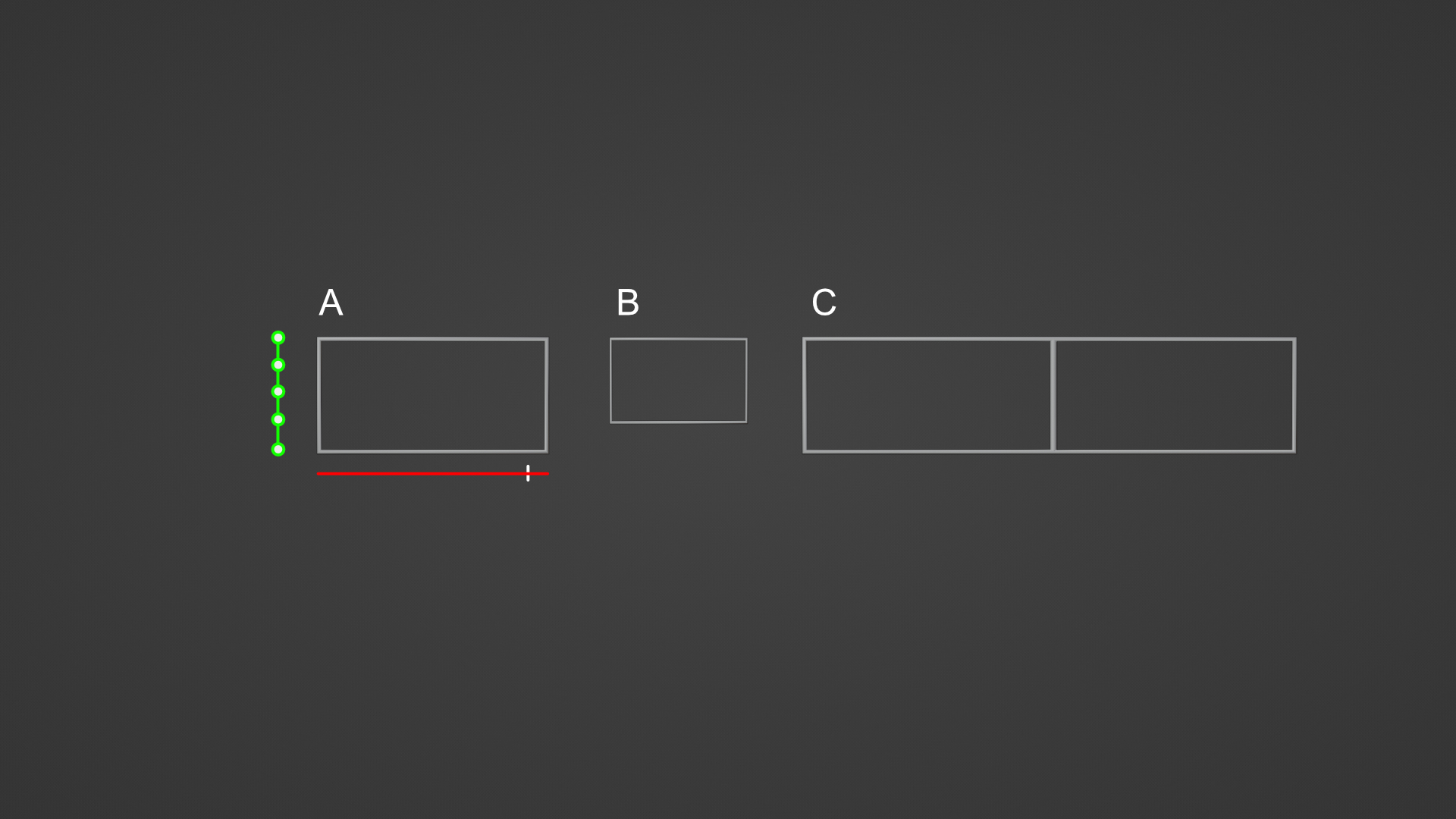

    I try to explain what I need to accomplish (all numbers are just examples). Please look at the attached image to understand my explanation:
    I want to make it possible to change the width and the height of an object. The width you should be able to control in a range of maybe 100-400 in steps of 1 by using the red slider in the attached picture at A.
    The height should be controlled with 5 fixed heights. Let’s say 20-40-60-100-160. This is represented at A with the green y-axis and the circles.
    Not every height is available with every width. If you look at B the width was reduced, and when it reaches a certain minimum width, it should automatically change the height to the biggest available for that width. (Also it should not be possible to choose a greater height than the max for this width at this point.)
    At C there is an additional element automatically added in the middle when a width about a certain amount was configured. This element should only show up above a certain width and should go away if I use the slider to lower the width.
