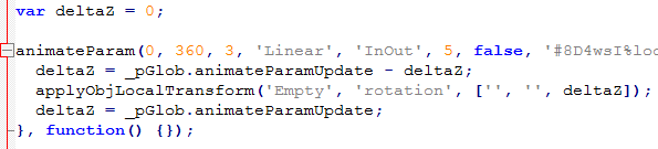

    I also used the “Change” puzzle and it does rotate correctly….But speed is accelerated and not constant.
    #66401
    Do not use updated value puzzle. Use some constant value for constant rotation.
    #66403
    that works….. thank you.

    Note that ‘repeat’ value means additional loops to the first loop.
