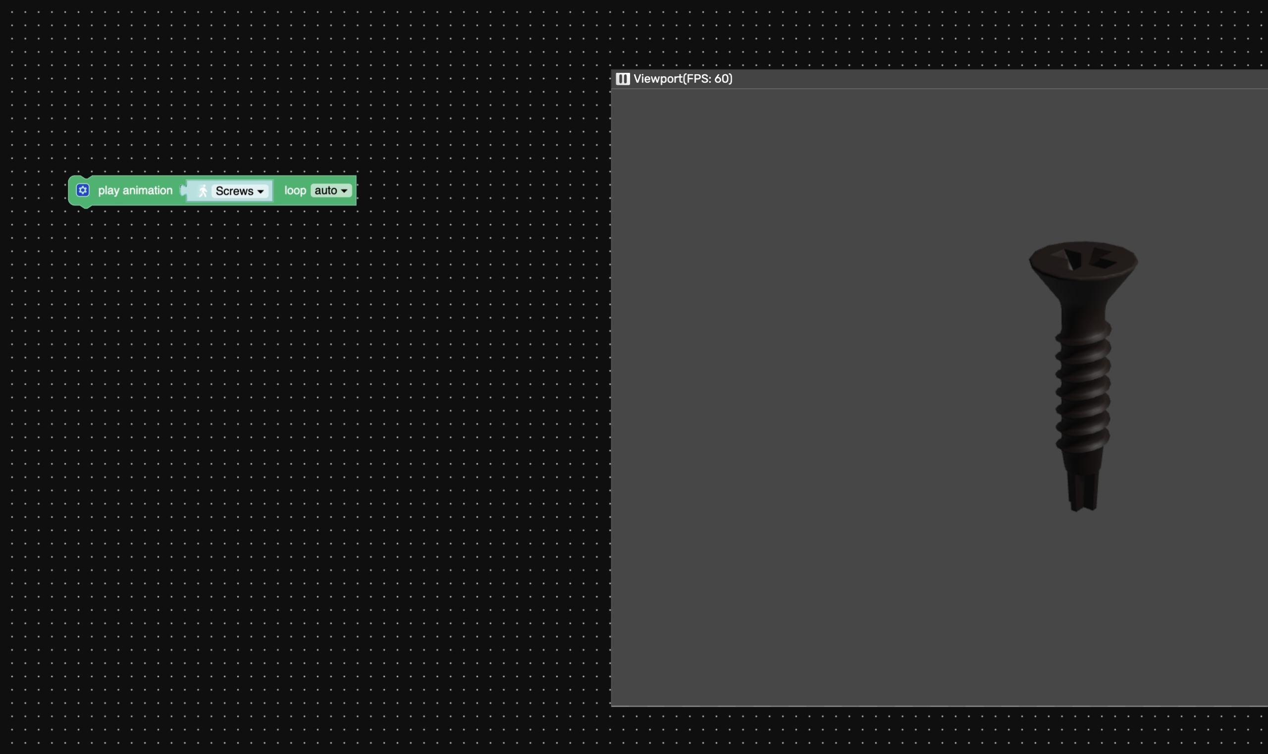

    You can create the animation in Blender and then use the PlayAnimation puzzle to play the aniamtion you created in blender.

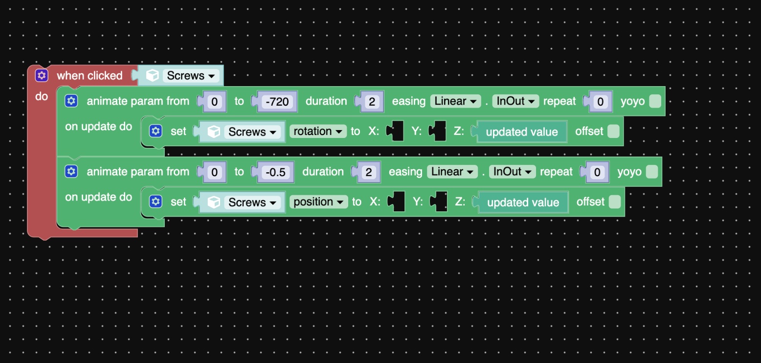

    You can rotate the object using object puzzle “set position (change position to rotation) and then increment the value via puzzles.

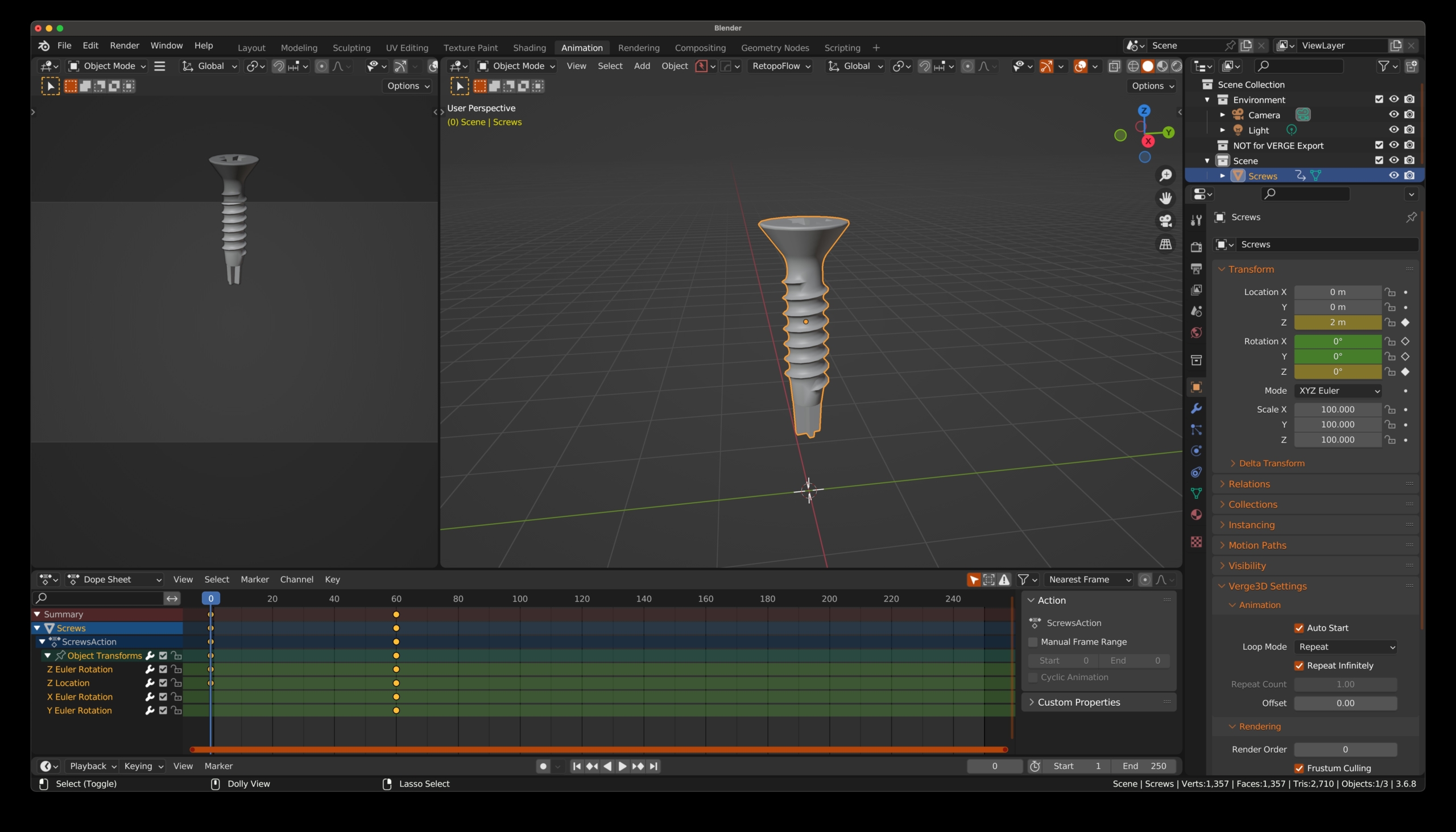

    Here are some screen shots for keyframing in blender…then using the Play Animation puzzle.
    or without keyframes using the animate parameter puzzle.
