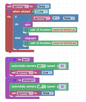

dssctrCustomerHey Crunch, I just saw this. Unfortunately, Storyline doesn’t make this easy. There’s more to it than just a working file. Pay attention to #4. Here it goes.
https://360.articulate.com/review/content/425f5f56-da82-481d-b054-3a6e3fdbdfc2/reviewI did this the old way and haven’t tried the new JS puzzle.
1. Inside your verge_name.js it should look something like this at the bottom of the script. Also, see the puzzle attachment(puzL.png) too.
//Verge passing variable to Storyline function prepareExternalInterface(app) { app.ExternalInterface.passvariabletrue = function() { var player=parent.GetPlayer(); var myVar = player.SetVar("variable",true); return myVar; } app.ExternalInterface.passvariablefalse = function() { var player=parent.GetPlayer(); var myVar = player.SetVar("variable",false); return myVar; } } //Storyline calls come here to trigger Verge procedure. function runCode(app) { window.spin = function() { v3d.puzzles.procedures.spin(); } window.stopspin = function() { v3d.puzzles.procedures.stopspin(); } }2. Excecute JS triggers in Storyline should look something like this
var iframeElements = document.getElementsByTagName("iframe"); iframeElements[0].contentWindow.window.spin();var iframeElements = document.getElementsByTagName("iframe"); iframeElements[0].contentWindow.window.stopspin();3. In SL make a webObject(iframe) and then go and rename your local verge_name.html to index.html. Target your webObject to your index.html.(right-click menu on WebObject and select your index.html) SL will make a copy of [all elements within the same folder as index.html (so you might want to remove your blend file first)] and SL places them into its own published WebObject>folder when you publish SL to Web option.
4.IMPORTANT: If your lucky, everything works. If not (because you need to tweak something in Verge), and you need to republish SL, you will NEED to rename your webObject’s folder name(doesn’t matter what) that has your index.html inside, and again retarget the WebObject to the index.html. If you don’t, it will never overwrite tweaks you’ve made in verge puzzles, js or glTFs.
Good Luck. -Rick
