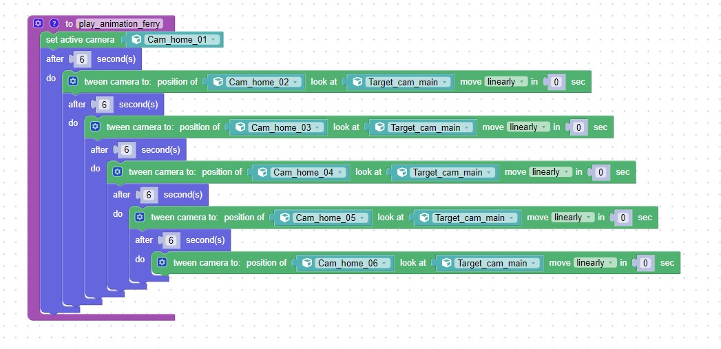

    Hi! I have a procedure that changes the cameras (and will do a few other things soon) to receive an effect of an animated intro screen. I would like that procedure to repeat infinitely (so restart each time after it’s finished). Is there a simple way to do that?
    #63635
    Call the play_animation_ferry procedure after the last tweening.

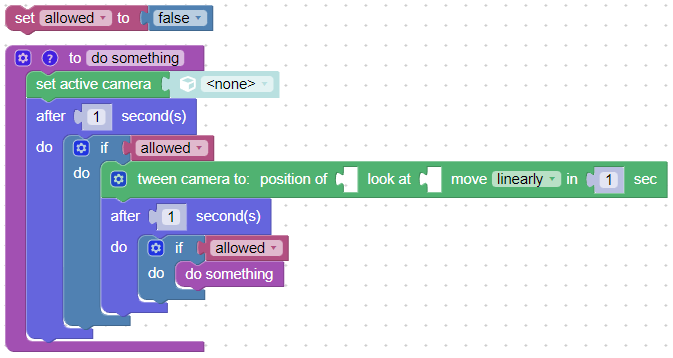

    #63645
    Use some variable to control the loop
    When needed set this variable to false

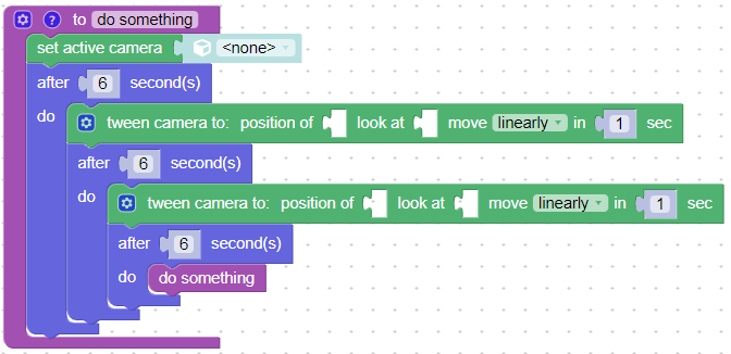

    Mariusz
    That seems like a fine solution in some cases, thank you. But how can I stop the procedure completely, in the middle of it? In the middle of this “animation”, whenever the user clicks the button?

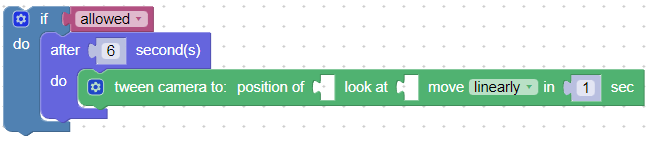

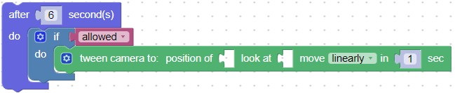

    #63648
    Check the variable state before every tweening. You are free to use conditions anywhere.

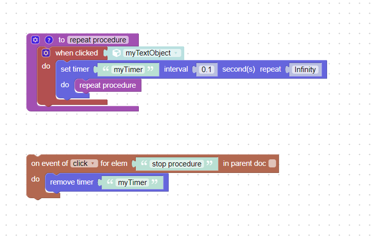

    tg
    Hi.
    Maybe using a timer can help.
