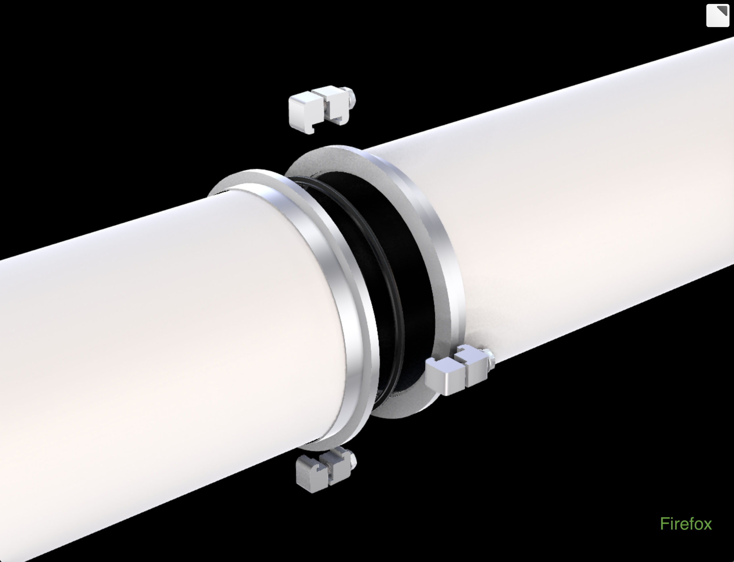

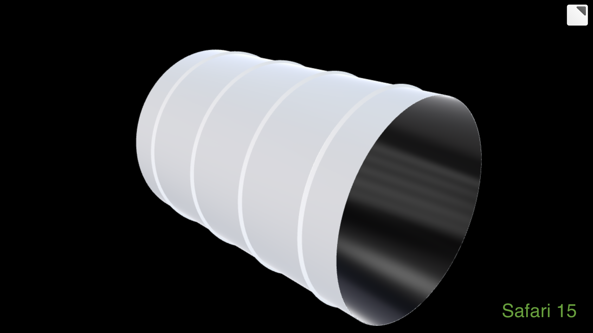

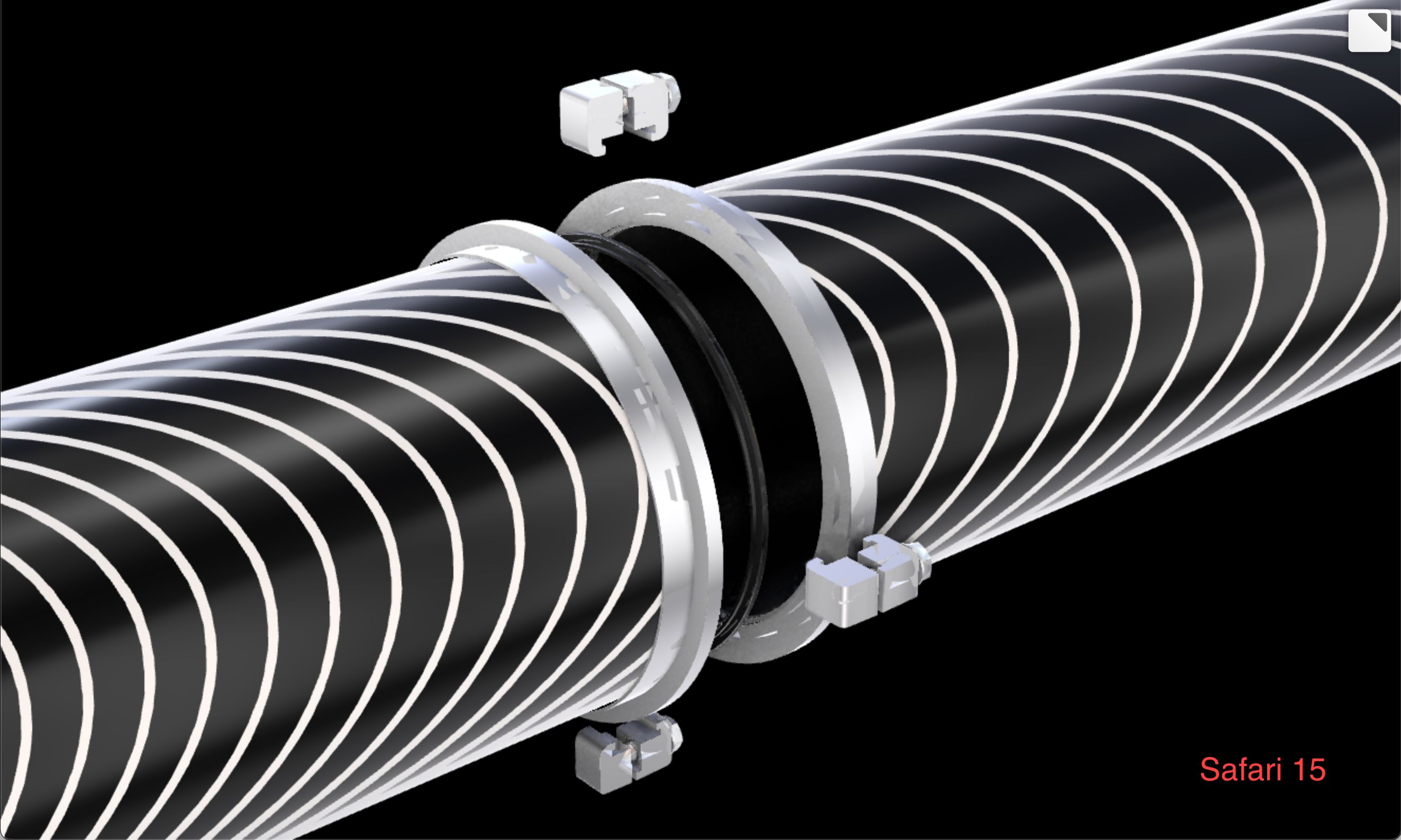

    I am seeing rendering errors when viewing my Verge3D apps with Safari on Mac or iOS (all latest OS versions–apps created in Verge3D for Max 3.9.0). Textures and geometry are rendering incorrectly. I have previewed on multiple Macs and iOS devices, and am seeing the issues.

    can you try to make more room between the black and the white surfaces? I think they are too close to each other, and Safari has troubles displaying that due to poor depth buffer precision.

    Thank you for the response. However, here is an example of another model, created with an older version of the V3D plug-in, which renders correctly, in Safari. The solid surfaces are identical to the example model that I put in my initial post, including thickness, proximity, and materials.
    Any more suggestions?
    -Rob
