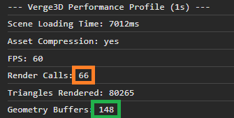

    #77361
    c4cc
    cloning puzzles
    https://i.postimg.cc/NjfTFYW1/o46x1.png
