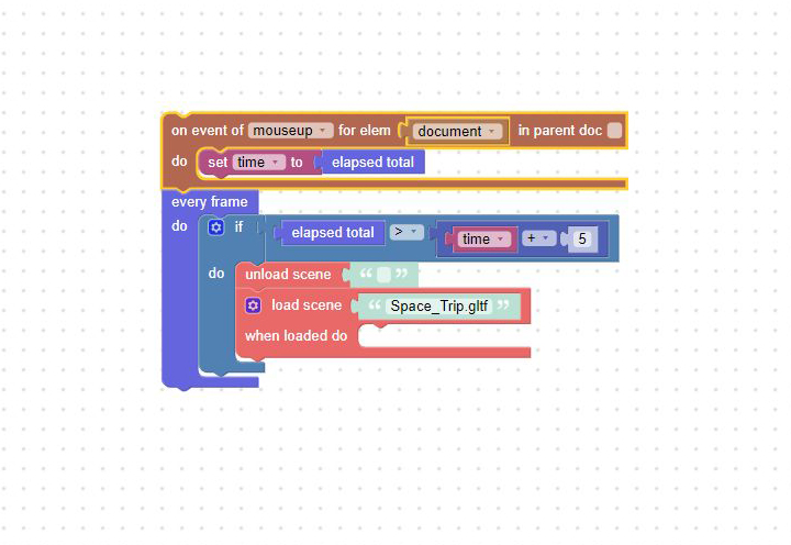

in my project i want to reload the scene after some idle time
I created a puzzle which should do it, see attachment.
i does unload the scene but does not reload it again…
the screen stays blank…..any ideas?Greets

xeonCustomerWe do this for a number of tradeshow installations where this type of interaction is required. If you have to do it this way you are better off handling it through a script in the parent window that just reloads the page.
We typically create an InitialState procedure….this has all the variables, positions, animations, etc….settings.
This procedure is then called on an idle time and the entire project is reset. This allows you to keep some stored data such as high scores, survey data, etc if desired.Alternatively…you could have two scenes. The first scene is what you could call and inactive scene… upon interaction it would load the second scene…your main project. On inactivity…you load your inactive scene and the process repeats.
There are many solutions to this general question so without more information I hope one of these will be helpful.

xeonCustomerOk…I have attached reload scene using simple puzzles.
Basicaly its a ball and a cube. The cube is animated over 30 frames.
The ball is a button…that will allow you to manually reset the scene.
The puzzles set up a scenario testing for an idle event. For simplicity, I have chosen if the animation is playing or not. The test will run every 5 seconds to determine if it’s playing. If it’s not playing the scene will re-initialize. You can interrupt the timer by pressing the sphere before the 5 seconds.This process just requires you move all your code into procedures and then call the procedures as needed based on the condition of inactivity you set.
This is just one option but eliminates reloading of the scene.

xeonCustomerSorry, this did not get you going in a favorable direction. The concept is that no matter how complex your scene is it can be reset based on how you initialize it. All your initial settings of the camera, location, animation, frames, etc…can all be stored in variables and thus in procedures. Once you have an initialize procedure…regardless of what you do you can call that initializing procedure and the entire scene would “reset”…even reloading the initial models if necessary.
But if that is not a technique you prefer there are many others. The easiest way is to have the parent window via javascript monitor event listeners on the mouse and keyboard and after a set time…just reload the page. That would be the easiest.
