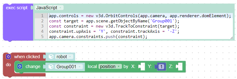

ParticipantAdd the
TrackToconstraint and it will work like here https://v3d.net/ps8 (use WASD to move).Or you can use this puzzle after moving your model. Set the time value to 0.

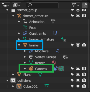

The camera is a child for an object you want to move and it moves together with its parent. The
TrackToconstraint forces the camera to look at its parent at any moment.

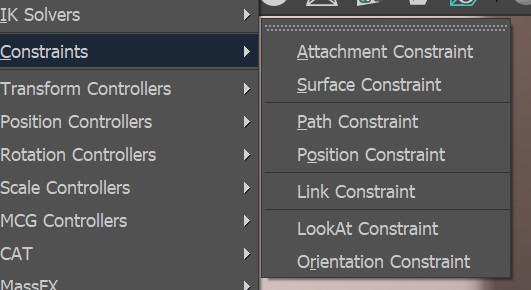

2023-12-30 at 2:53 pm #69415
QiangGeParticipantI used 3dsMax, and the principle should be the same as what you described. I tried both methods, and the result is similar to the demo I provided earlier. The camera follows the parent object and always faces the target object, which is correct. However, the issue arises when the target object moves away from the origin—the orbit path becomes strange. Could it be a bug specific to the Max version?

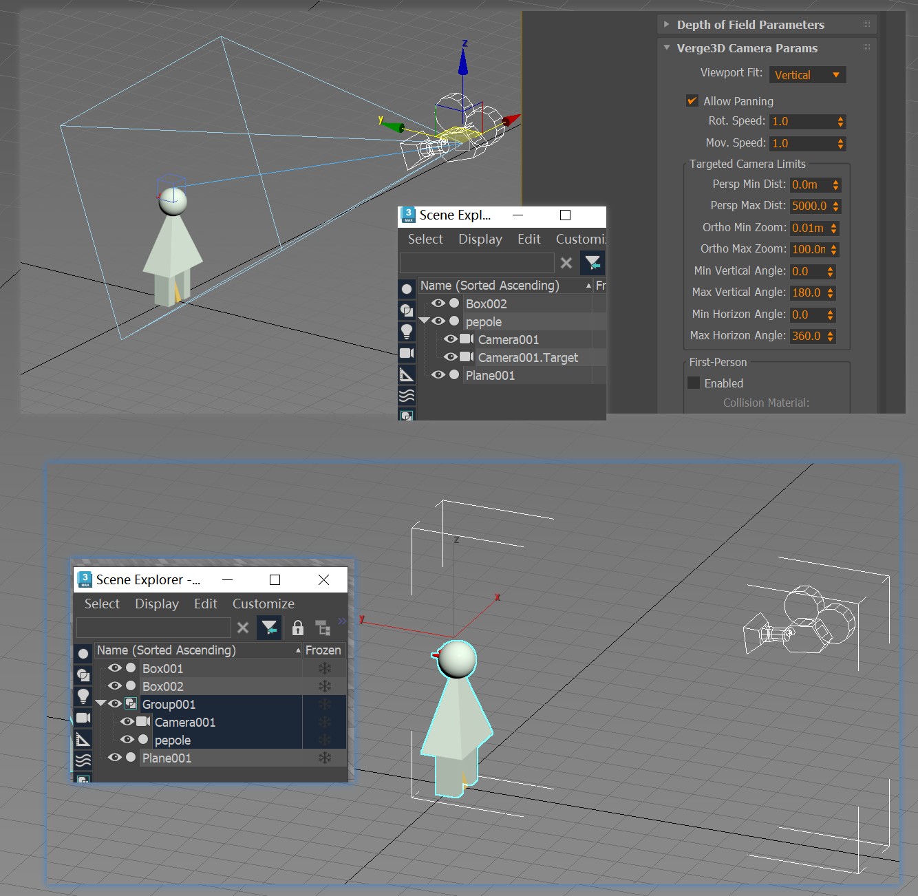

2023-12-30 at 3:14 pm #69418kdv
ParticipantIn fact, your scene’s camera has no controls at all. You add Orbit controls later in
visual_logic.js. Why? Can’t you export you scene with Orbit controls chosen in 3Dmax?Puzzles and JS coding. Fast and expensive.

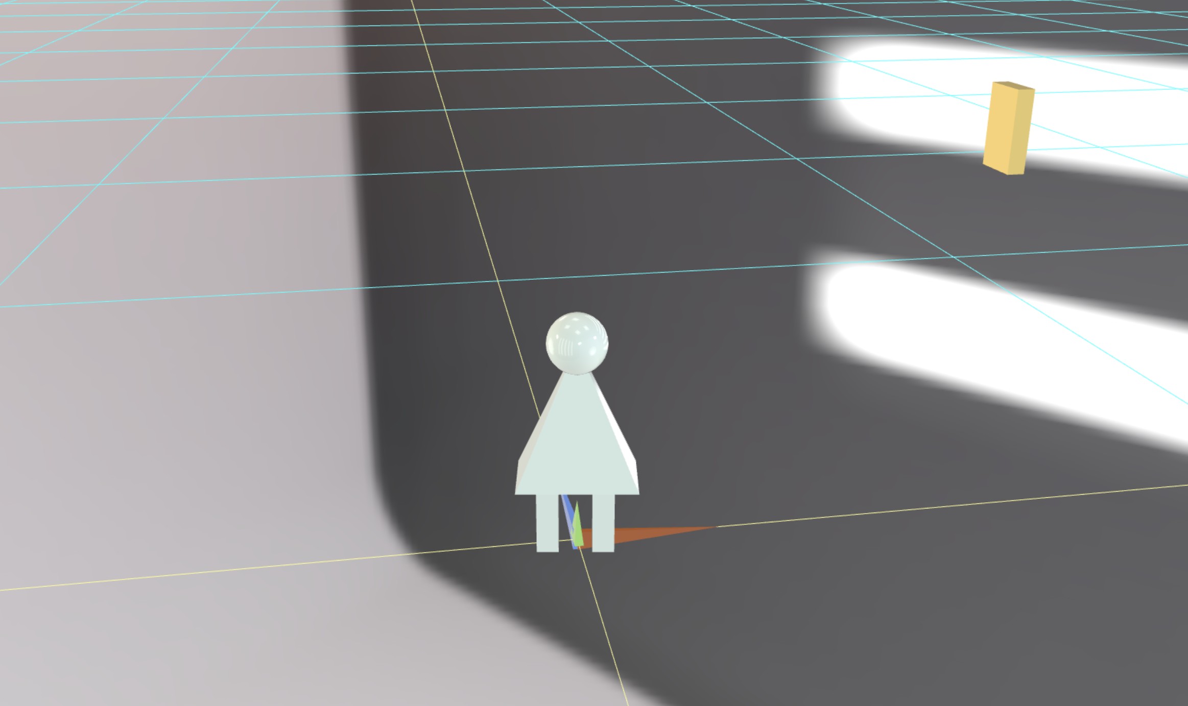

QiangGeParticipantdemo2
I’ve uploaded a demo that uses the default controls with the method I used last night. Please take a look. Shanks KDVAttachments:

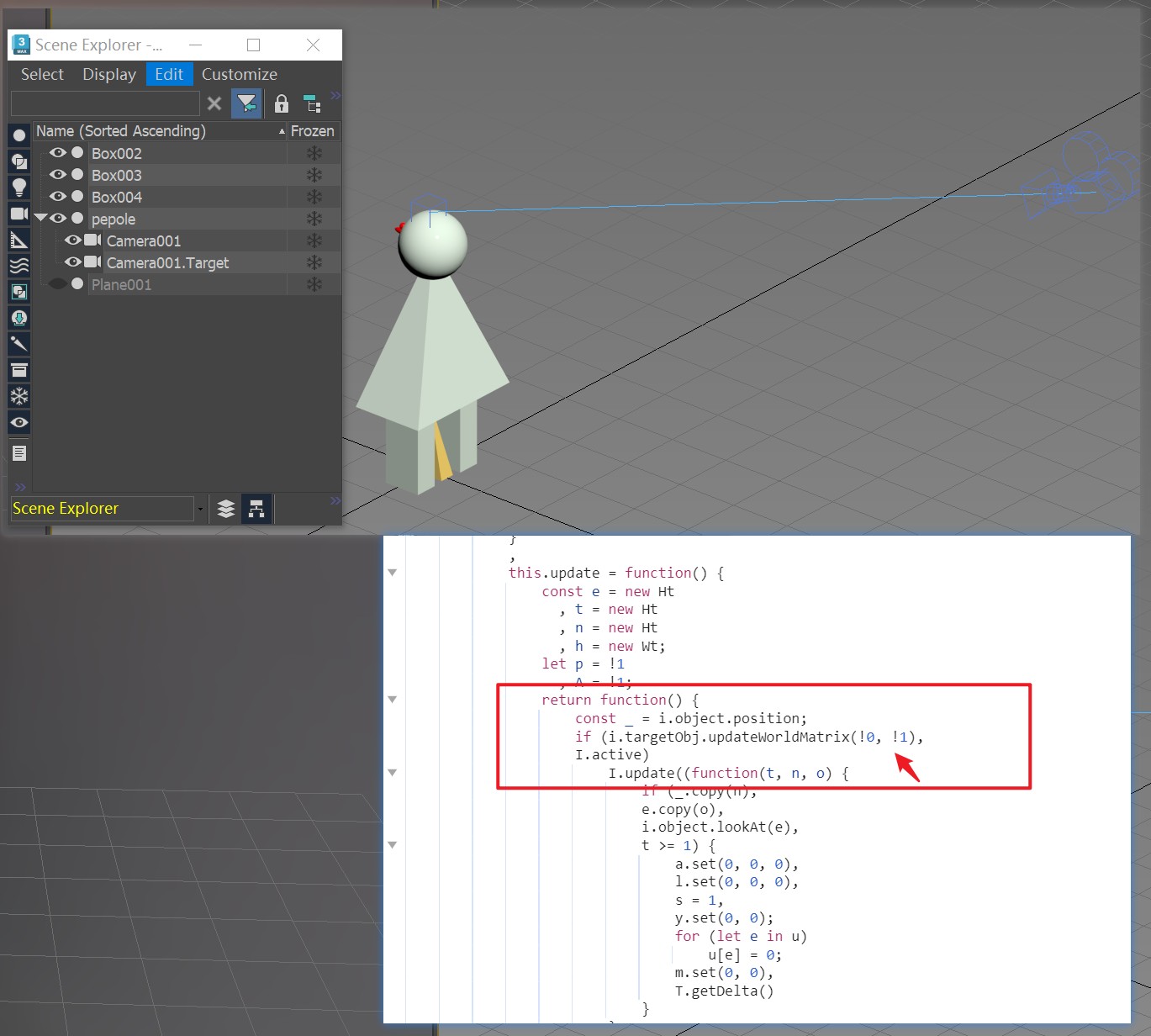

QiangGeParticipantYes, your Blender export is correct. I had suspected an issue with the matrix transformation in the update function of OrbitControls. if (i.targetObj.updateWorldMatrix(!0, !1).
I hope someone can verify whether this is indeed a bug that exists only in the Max version.

Posts lost, resend the demo.2023-12-30 at 4:50 pm #69429kdv
ParticipantYou have “Camera001.Target” parented to “pepole”. Thus the position of “Camera001.Target” is always (0, 0, 0). This object is an orbit center.
app.controls.targetObjshouldn’t have any parent or its parent should be the scene itself. It should have position in the world’s coordinates. Have no idea why in Max it’s exported this way.Puzzles and JS coding. Fast and expensive.

ParticipantIf you can’t add the constraint in Max you can do it using JS code.
