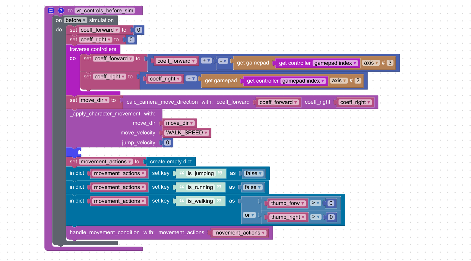

    Im trying to base an interactive experience on this app, and want to use the controller buttons (oculus) for other events. I can see in the puzzle where you use the trigger and squeeze and thumbstick.. How would I add the use of the other buttons?
    #52090
    Hi, please use the following example from Snowballs demo. Replace axis with buttons and try different indices to detect more controller buttons.
    #52102
    Micdsn
    Cool — I’ll try it–thanks!
