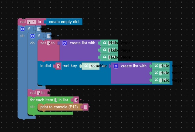

    Usually i use Chrome browser to load puzzles editor. A long time i was suffering from very slow work of puzzles editor in big projects. It took a long time to scroll puzzles editor window. I tried to make new empty tabs regularly , but it helped until some puzzles appeared and then again became very slow.
    But today i loaded puzzles editor in firefox browser. And its a miracle – editor fly!
    But there is a bugs in displaying puzzles (attached screenshot).
    When i click on bugged field its became correct. And when i’m load project again its displays incorrect again.
    Can you advise what to do to see puzzles correct in firefox?
    Thanks!

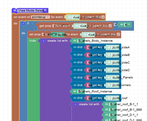

    When we expand collapsed puzzles they will display incorrect (on screenshot)
    Project created in Verge3D 3.9.1
    Here is link to project demostrating the bug.
    https://dropmefiles.com/NZP8c
    Take a look, please. Thanks
    #51724
    We’ve managed to reproduce the bug. The issue is in a particular version of Google Blockly which Puzzles is based on. Currently, it works well in Firefox in their latest release, so we’re thinking about updating Puzzles to the newest Blockly version.
