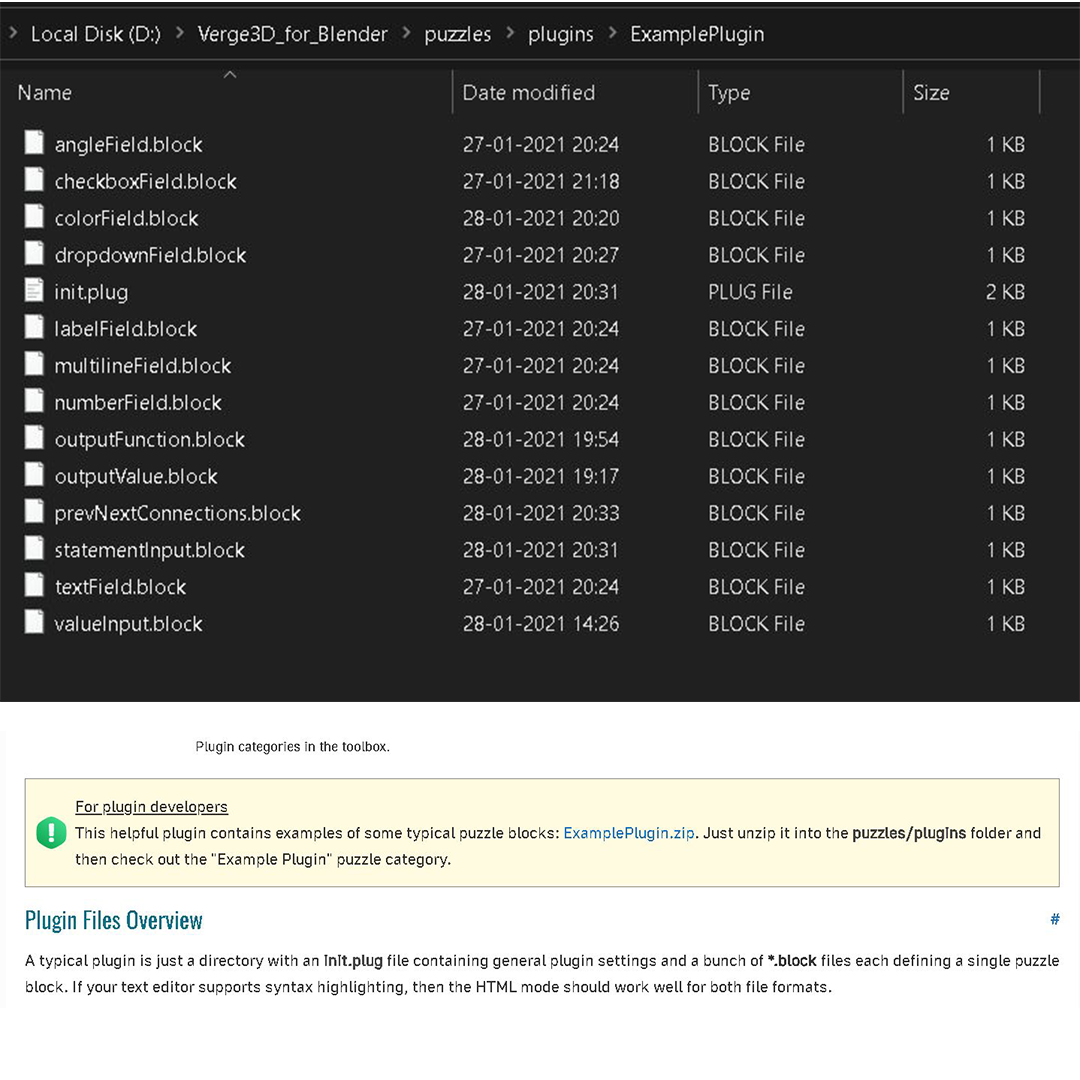

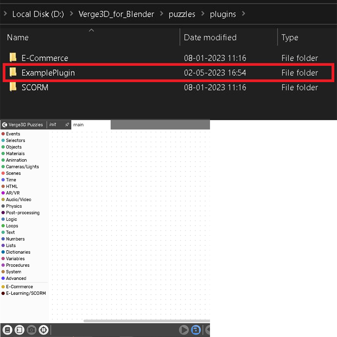

    Below I have attached 2 images, these two contain the instruction saying to upload the ‘Exampleplugin.zip’ file in ‘puzzles/plugin’ and the result will display the puzzles in puzzle editor which in my case didn’t and is evident from the screenshots I have attached.
    Please refer and share the solution for the same.

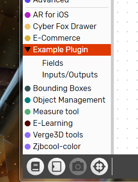

    Works with no problems :unsure:

    You saw the photos I shared, and the steps written by me that I followed, did I make a blunder in understanding any step?
    We both did the same thing right? Or am I missing something? :scratch:
    #63580

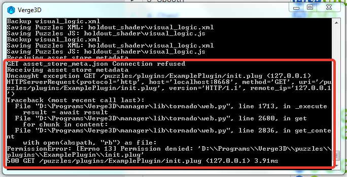

    According to your screenshots it should work. I suppose that’s the matter of permisions. You could install Verge3D as one user and copy plugin’s folder as another user (or administrator). As a variant. So check permisions.
    You can see the possible reason (if it is) in the Verge3D server log
