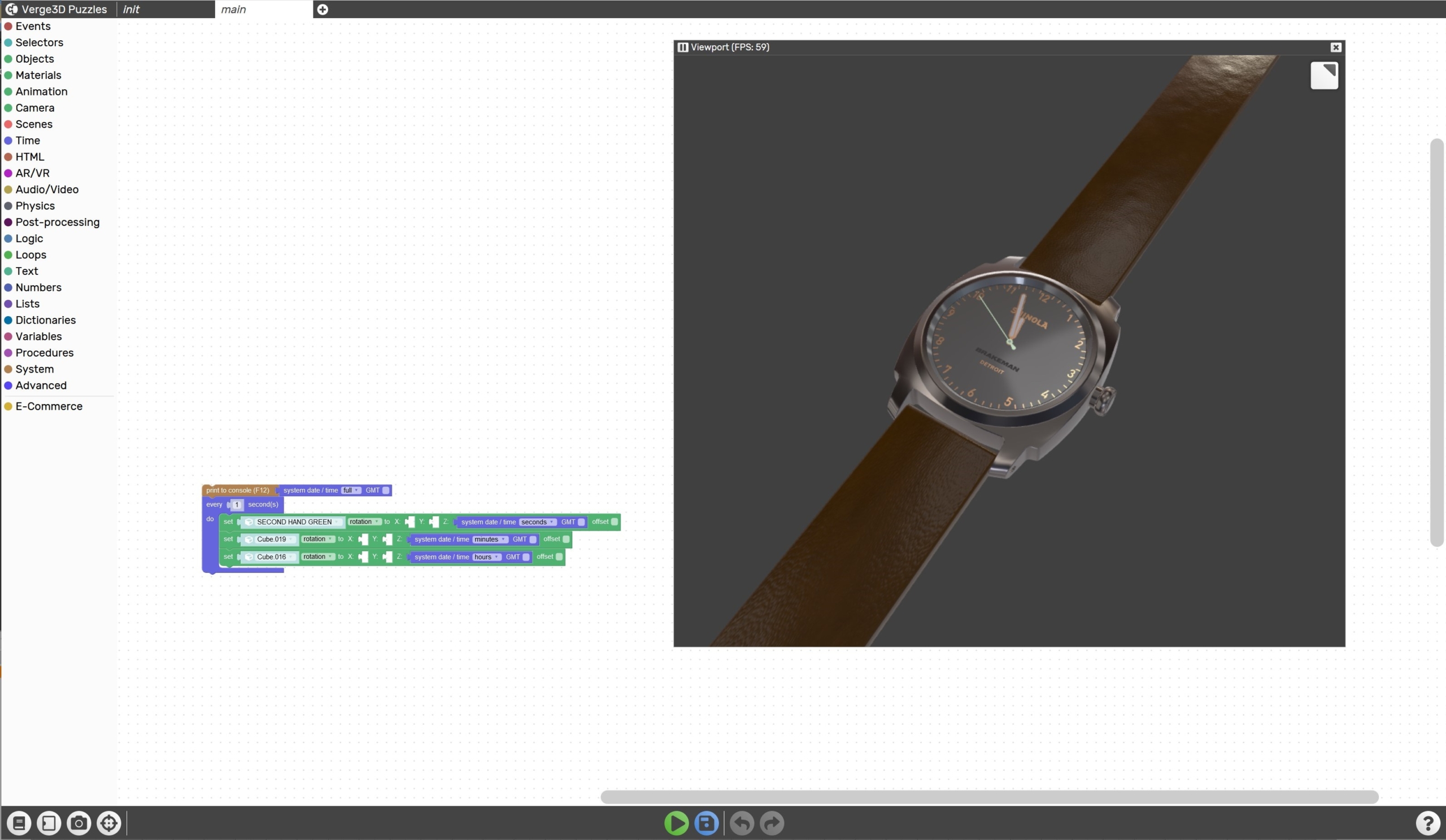

mcolinpCustomerHere is what I have so far. I have managed to create the proper relationships using Verge3D puzzles to get the proper relationships between the hour hand, and the minute hand; in regards to the second hand animation. Still struggling to see how I could get the hands to position themselves on load using the time puzzles.

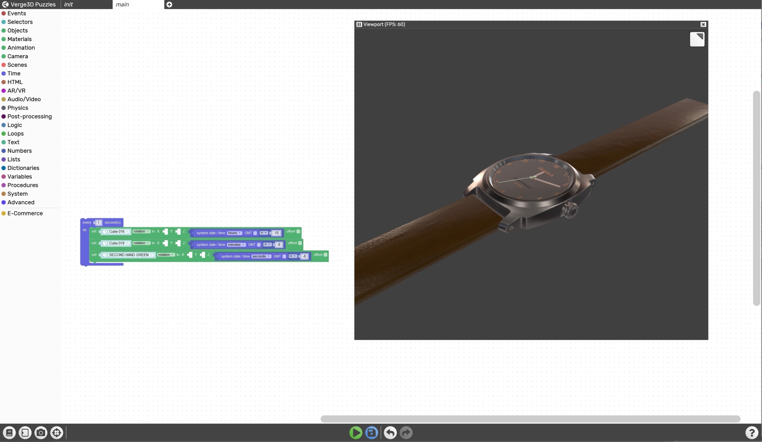

mcolinpCustomerSo I have tried various setups with the puzzles you specified, but I am still coming up short. An additional issue, is that the rotation by default, goes counter-clockwise. I tried reversing the local axis for each ‘hand’ in Blender, but it still rotates the opposite direction from what I need. Also, while the hands do move based on the puzzles, they do not reflect the actual rotation based on the Time puzzle. (At the time I made these screenshots, it was after 8:00 am here.) Of course I am likely missing something here. Here is a picture of the latest configuration:
2021-02-17 at 2:02 pm #38665
Yuri KovelenovStaffrotation by default, goes counter-clockwise
yes, you can use negative rotation
For hours – 12 hours make 360 degrees, so 1 hour is 30 degrees, thus you need to multiply your amount of hours by 30.
For minutes and seconds – same, but multiplier should be 360/60 = 6
2021-02-17 at 5:19 pm #38666
mcolinpCustomerI get what you are saying, I’m just not understanding what puzzle configuration I can use to make the time generate, translate into those values.

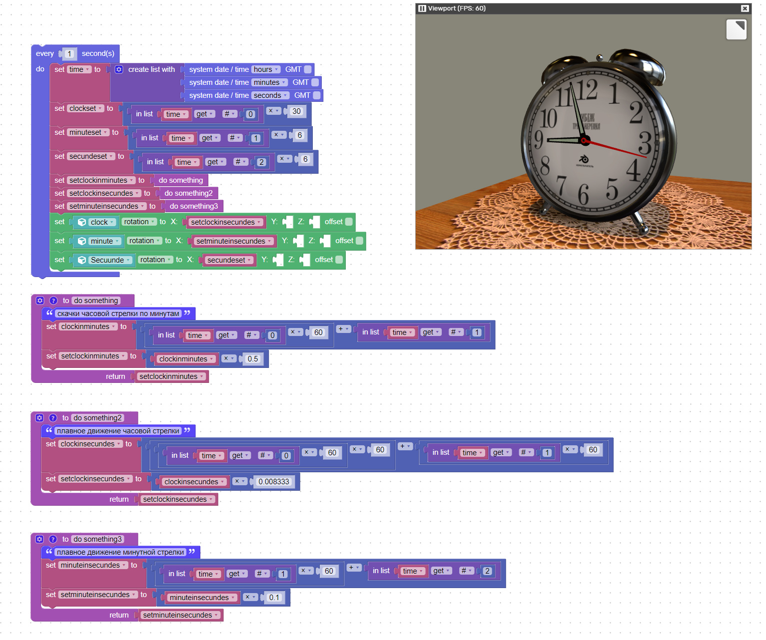

Mikhail LuzyaninStaffHere’s an example for you.

alexlopatinCustomerYou can use my example or and improve it
