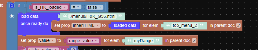

    I have some troubles reading the id’s from an external html file…
    The HTML is embedded trough puzzles with a set prop innerHTML to a div(top_menu_2) inside the index html.
    What I want is bassicaly to show the annotation when i click on the button with id=magazine_1 from the external html.
    Thanks in advance
    #48617
    hi,
    I think you need to move the on event/click puzzle inside the load data puzzle. Otherwise it tries to initialize the button which does not exist yet.
    #48618
    deedox
    Thank you Yuri. Simple as that :)
