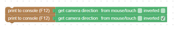

    Inverting only works in pair with “from mouse/touch” option, which is a bit strange. If you reproduce attached setup, you’ll see identical vectors.
    #79523
    Hi, this appears to be a correct behavior. The “inverted” checker inverts the 2D cursor coordinates, not the final vector returned by the puzzle, hence it has no meaning when “from mouse/touch” is disabled (basically in that mode the coords are [0, 0] – the center of the screen).
