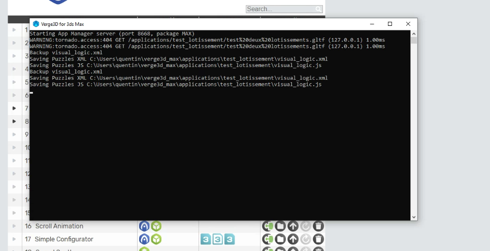

    elsword24
    I tried to launch with the app manager of 3DS Max but the problem is still the same. The app manager is launch and is working
    #41022
    strange – it prints 404 errors in the console – the gltf file not found. Are you doing any operations with loading/appending scenes in runtime? if so, can you show your puzzles?
