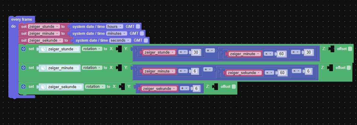

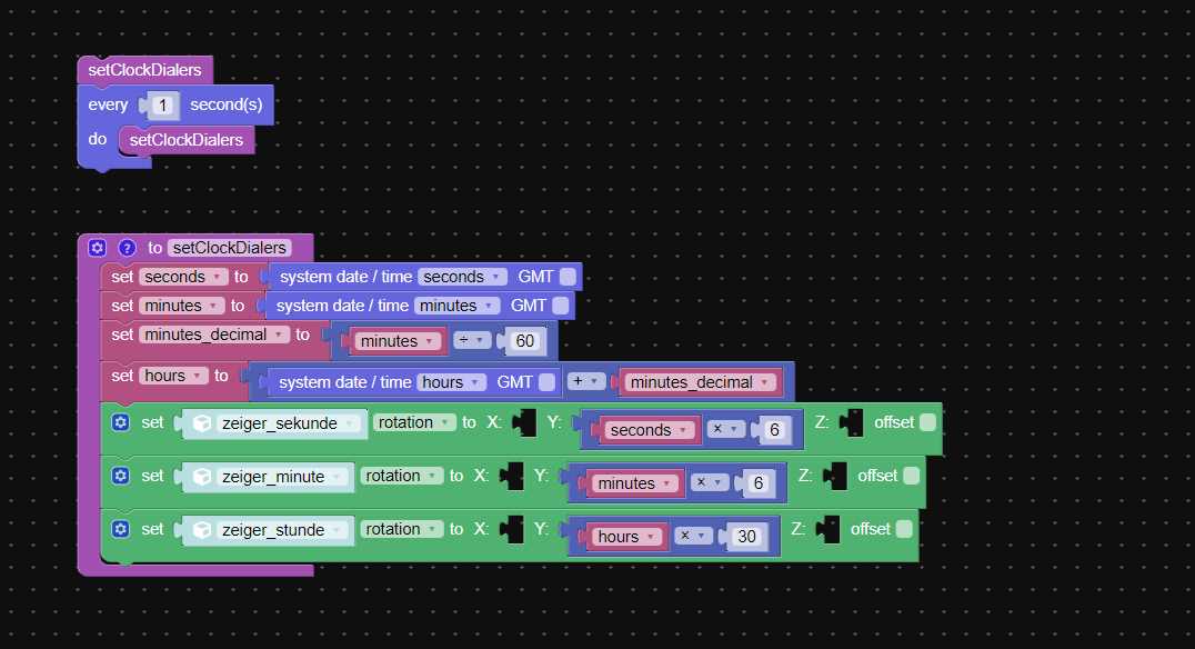

    I’m working on a wristwatch, following the puzzles from this link but having some issues
    First, the time the watch shows is not correct and then the “second hand” goes from 55 seconds to 13 seconds and then jumps back
    the 3d model has all the hands set to 12’a clock positions
    Below the puzzle I recreated from that previously mentioned post
    I did create 3 variables: zeiger_stunde, zeiger_minute and zeiger_sekunde
    I didn’t do anything else in there yet
    Am I missing something?
    I also saw that user @kdv answered with a code snippet, but I don’t understand where and if I have to put this in
    I hope someone here can help me to get this sorted out

    #63989

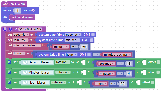

    You’ve re-created wrong logic from the post with not quite correct logic…
    https://v3d.net/k1c

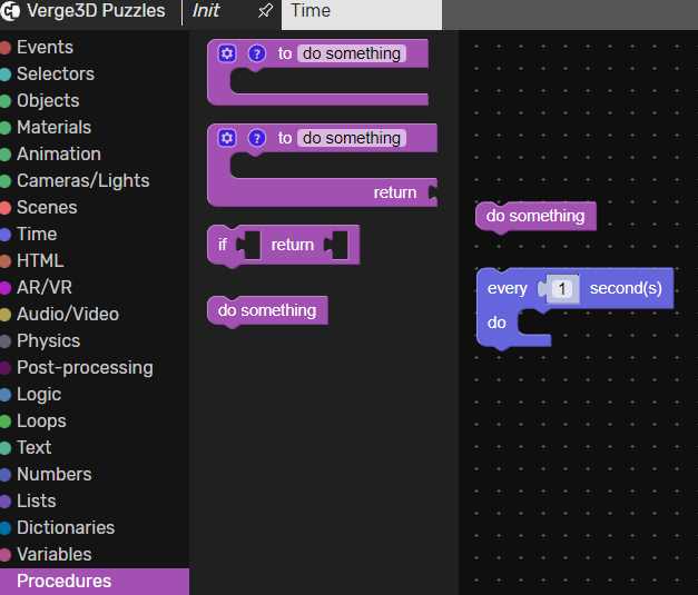

    How do i change the name of the procedure from “do something” to “SetClockDialers”?
    Really cant figure that one out :wacko:

    #63992
    Just click on “do something” and type in whatever you want.
    #63993
    3dcgi
    that doesnt work
    i tried left click, double click and right click
    when I left click within the procedure library then it jumps into the main scene and right click only provides me with some options like save to library et cetera
    Senior CGI Artist @ 3DCGI.Studio #zerophotography
    ➤ Unreal Engine - 3ds max V-Ray
    ➤ Hyper-realistic 3D. Cars, Motorcycles, Products, Archviz Visualizations, 3D & VFX Animations
    #63995
    3dcgi
    ah, disregard that
    I figured it out
    Had to select the main procedure first

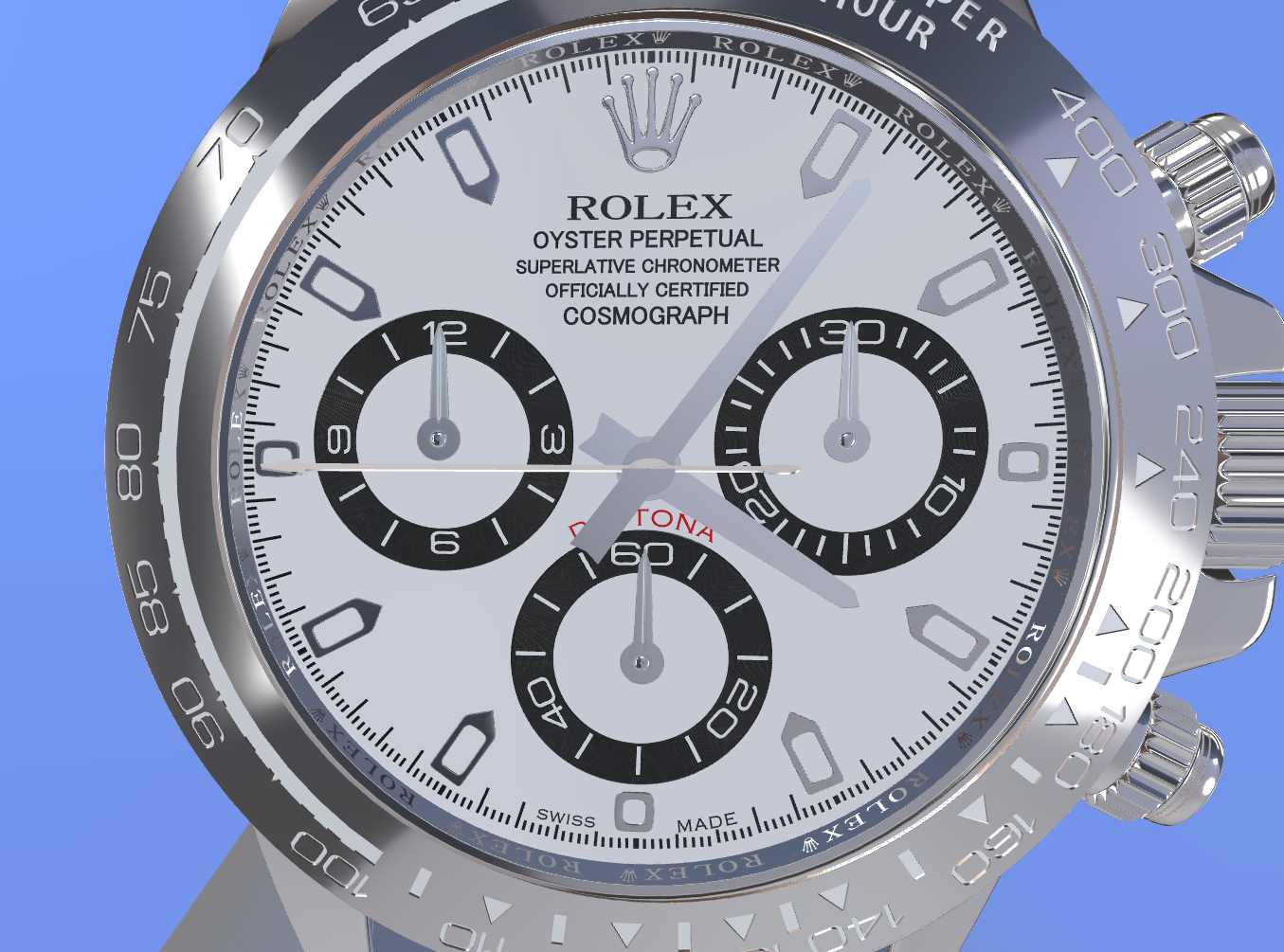

    Something weird is happening
    now it shows the time correctly, but when it reaches 15 seconds, the second hand starts rotating over the Z axys
    same happens when it reaches the 45 second point
    First I thought it had something to do with the meshes, so I recreated all 3 hands from scratch to be 100% sure that there wasn’t any issue with the pivots, but it keeps happening
    I created the puzzle exactly as @kdv showed me (thanks to him for the incredible support on my last posts )
    Any idea whats going on here?

    #64000
    3dcgi
    here a screen recording of the watch
    #64001
    3dcgi
    seems the mp4 was too big, so here a link to it https://vimeo.com/829612929/e247b67053
    starts at 2sec

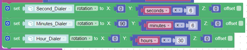

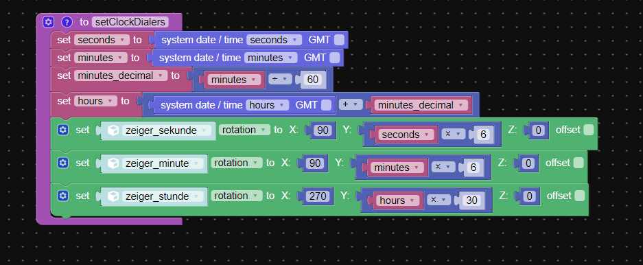

    #64002
    reset rotation for the dialers. the initial rotation should be 0,0,0. or you should set correct angles every time.
    In my demo the minutes dialer is initially rotated by 90° (don’t know why. it’s not my model). so I need to set X rotation to 90° to eliminate that “15-45” issue
    But it’s better to set rotation to zero values.
    #64004
    3dcgi
    had to play around a bit with the X values, have it set now to those values and it seems to work just fine
    Thanks for your great help :good:
