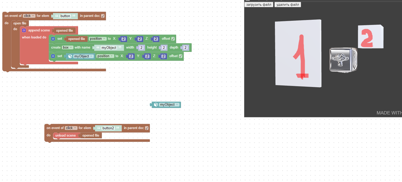

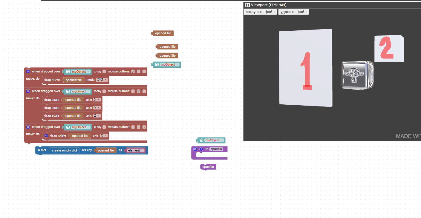

    I can not change the position of the uploaded file “1”. I do not know why. I had to come up with crutches and move it through the movement of the cube “2”. what to do? where is the mistake? thank you in advance

    hi,
    the ‘drag’ puzzle is initiated before the scene is loaded. So you should move this puzzle inside the ‘append scene’ puzzle.
    #50862
    pank1
    thank you :heart: :heart:
