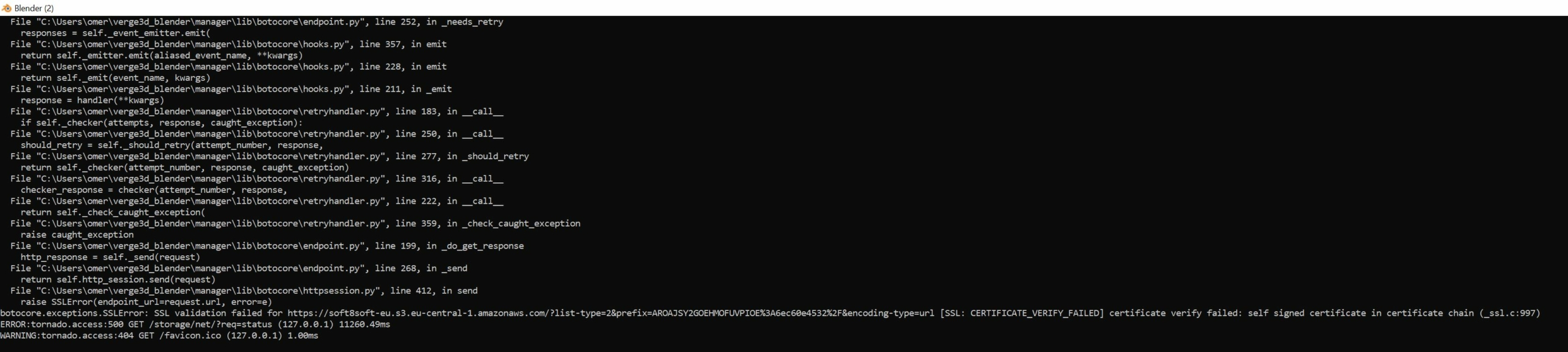

    okfir
    I attached the screenshot of the Blender console
    #50971
    It’s possible you’ve got some untrusted certificate installed in your system. Perhaps you installed some security software (e.g to handle smart tokens keys)?
