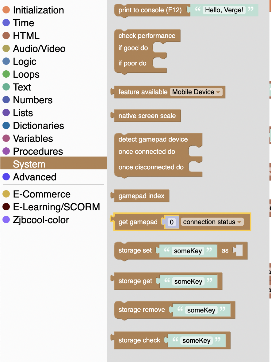

    I can not seem to find the ‘print performance info’ puzzle.
    I am using an M1 Macbook Pro if that makes any difference.
    Thank you!
    Dominic
    #77244
    You are in the “Init Tab” change over to the “main” tab or any other tab in the Application Manager then look in the Systems puzzles and you will find it. Since you cant place the Print Performance puzzle in the “Init” tabl the puzzle is not displayed.

    Fixed! Thank you :)
