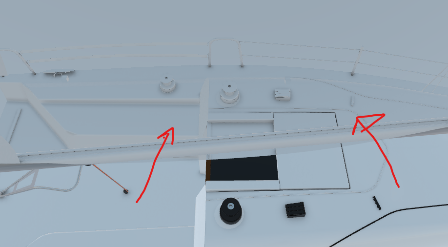

    Sadly, I think I still have the same problem – see screenshot looking through the backside of a thin surface with double sided render settings and opaque blend mode enables with AO.
    #68955
    This appears to be the other issue (described in this topic), not the Emission factor.
    #68956
    PLAN8
    Ahh, so it is! My mistake, sorry!
