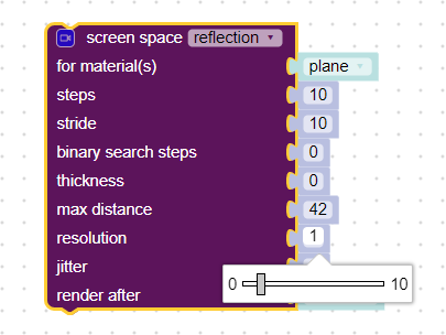

    Hey I have been trying to apply post processing effect screen space reflection to my scene but when for some reason it doesn’t load in the final scene. It does show in the live preview window when applying on the puzzle page but once i save it and view it in the final scene, it doesn’t appear. Could you please help me with it.

    This happens because you set the ssr resolution multiplier to 10 in the puzzle. That means that the ssr effect needs a buffer 10 times larger than the viewport size. WebGL has limits on the maximum resolution that you can use, and it simply won’t work if you exceed the limit.
    That’s why it works in in the puzzle editor where you have a smaller viewport and doesn’t work in the final scene where it’s almost fullscreen. I’d recommend to set the resolution to 1 and increase it only if the quality of reflections is not satisfactory.
    Thanks, I will try this.
