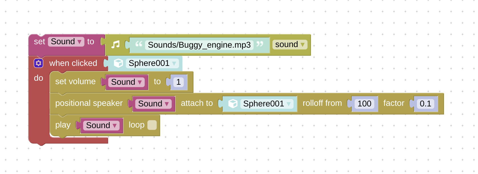

CustomerHi Guys,
I working with Max 2022 and verge 4.8.0
I´m trying to find out how this positional speaker puzzle works properly…
I´ve attached it to a car driving by….the car is linked to a dummy which follows a path
through the scene……i dont hear a thing….the settings ( rolloff from and factor ) zhere is no change whatever
settings i use….the path to the soundfile is fineQuestion:…….What unit do the settings follow……?
Greets

Yuri KovelenovStaffThere were some issues in the puzzles: nested use of sound puzzles, wrong case in the file name (Buggy_Engine.mp3 must be Buggy_engine.mp3 – important for working on the server), “rolloff from” means distance so it should be 100 if you are working with centimeters. The sound file must be loaded before clicking happens. I also made the factor lower to make the effect more pronounced.
Here you go:
2024-11-29 at 9:49 am #79158gf3d
CustomerThanks…it works now….even on my animated Buggy…driving around…great thing
