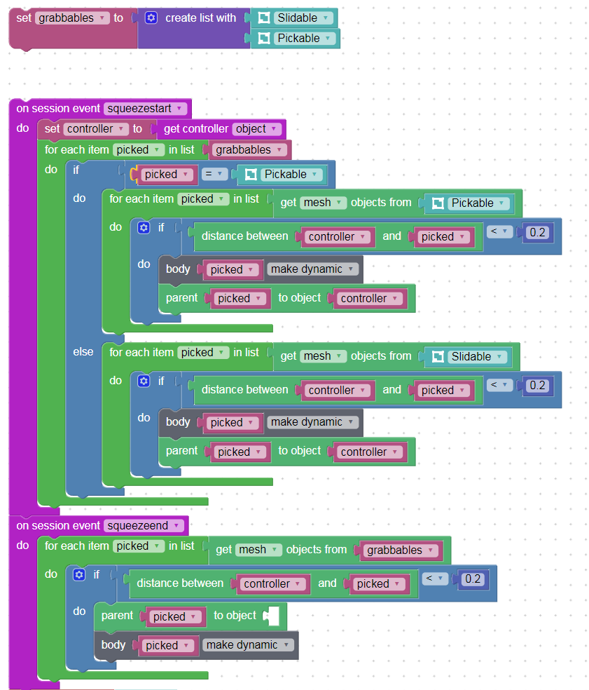

    I’m making progress thanks to this group on grabbing within my VR app.
    I am trying to have 2 collections in my blender file that are able to be grabbed, but one of the collections only moved on the z axis. I’m able to lump the 2 collections together with variables, but referring to them separately is not working… I know i could probably hard code the names of all the objects in the second group to make them a variable may work but what am I doing wrong? See puzzles.. As it is, no group is grabbable but if I leave out the narrowing down to one collection i can grab from both collections no problem.

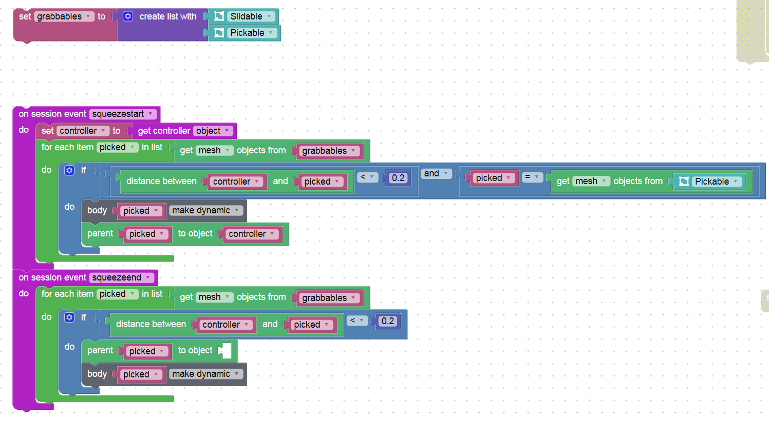

    #75769
    The condition after “and” will never be “true”. A string cannot be equal to an array.

    Micdsn
    Thank you for trying to make it clear, but I’ve been trying and can’t get it to work selecting from 2 different collections exclusively, with the idea to handle each group grabbed with different constraints. Could you suggest something?
    Al least use the correct conditions when trying to check if an object belongs to one of your collections.

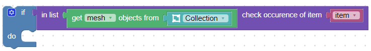

    Wrong conditions:

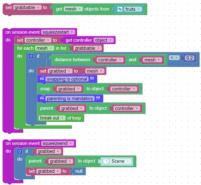

    Grabbing objects from a collection (group)
