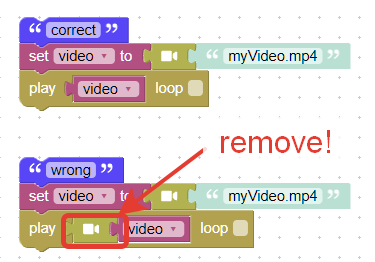

    there is a bug in the play video puzzle, if I copy puzzle from an older verge version it works.
    Difference in the visual_logic.js
    WORKING
    video = loadVideo(‘video/videotest.mp4’);
    replaceTexture(‘cube_material’, ‘Cookiehead.jpg’, video, function() {});
    playSound(video, true);
    NOT WORKING
    playSound(loadVideo(video), true);
    #78142
    There is an error in your logic in the second variant. Get rid of “loadVideo” in “playSound”.
    #78152
    tomtm
    Hi kdv
    thanks, true… this was my mistake. :wacko:
