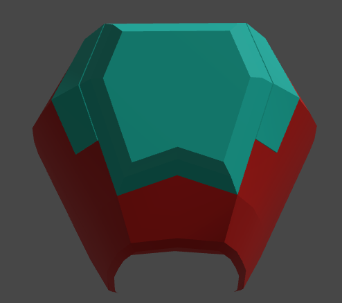

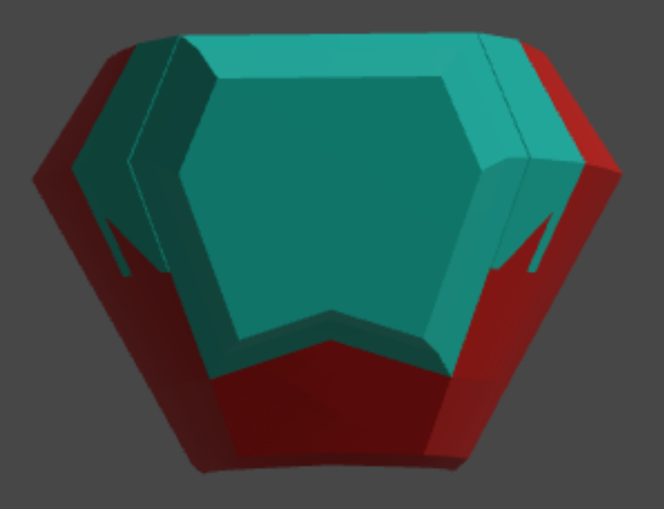

    Object on another in Blender:
    kurumii

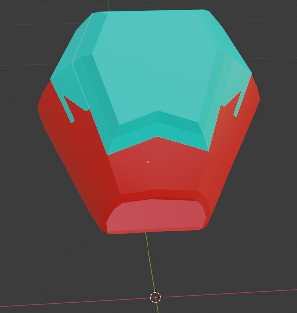

    Object on another in Browser:
    kurumii
    How to make object show fully in browser? Thanks
    #65986
    Wrong geometry. After triangulation you get what you get…
    Twisted polygons, a lot of them…
    #66011
    c4cc

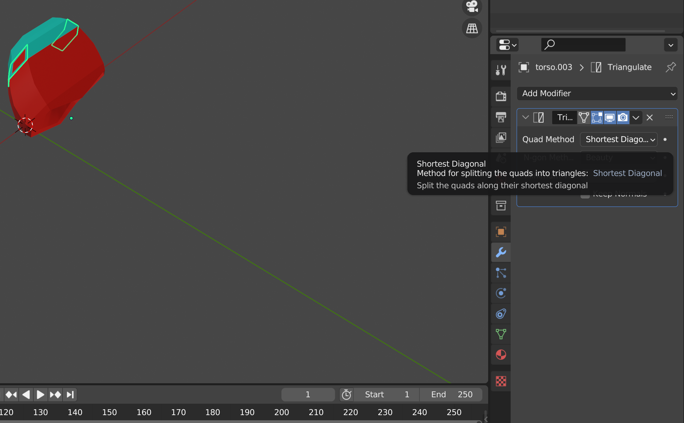

    So what triangulation settings do I set here? Also, do I have to use triangulation modifier on all the objects, or only the ones deformed in the browser?

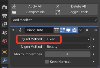

    #66013
    Just add (do not apply) the “Triangulate” modifier to both meshes and keep it active while modelling to see how your meshes will look in Verge3D. Any mesh is triangulated in Verge3D with no exception.

    c4cc
    I tried, but sadly no change
    #66021
    What changes did you expect? Triangulation only shows what’s wrong with your meshes. It won’t fix geometries, you just see the same in Blender and in Verge…
    #66024
    c4cc
    I was hoping the meshes would not get messed up or distorted
    #66025
    Except (and instead of) hoping you could experiment with some options in the “Triangulate” modifier…
