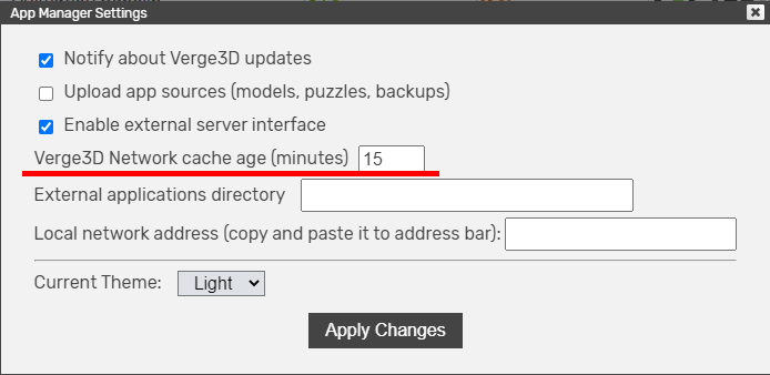

    #29761
    By the way this only happens on uploaded project.
    Do you mean uploading on the verge3d network from the application manager or are you using some other server? This is probably because of server caching, that’s why you don’t see the changes immediately.
    If you are using the verge3d network, then you can lower the cache age in the app manager settings here:
