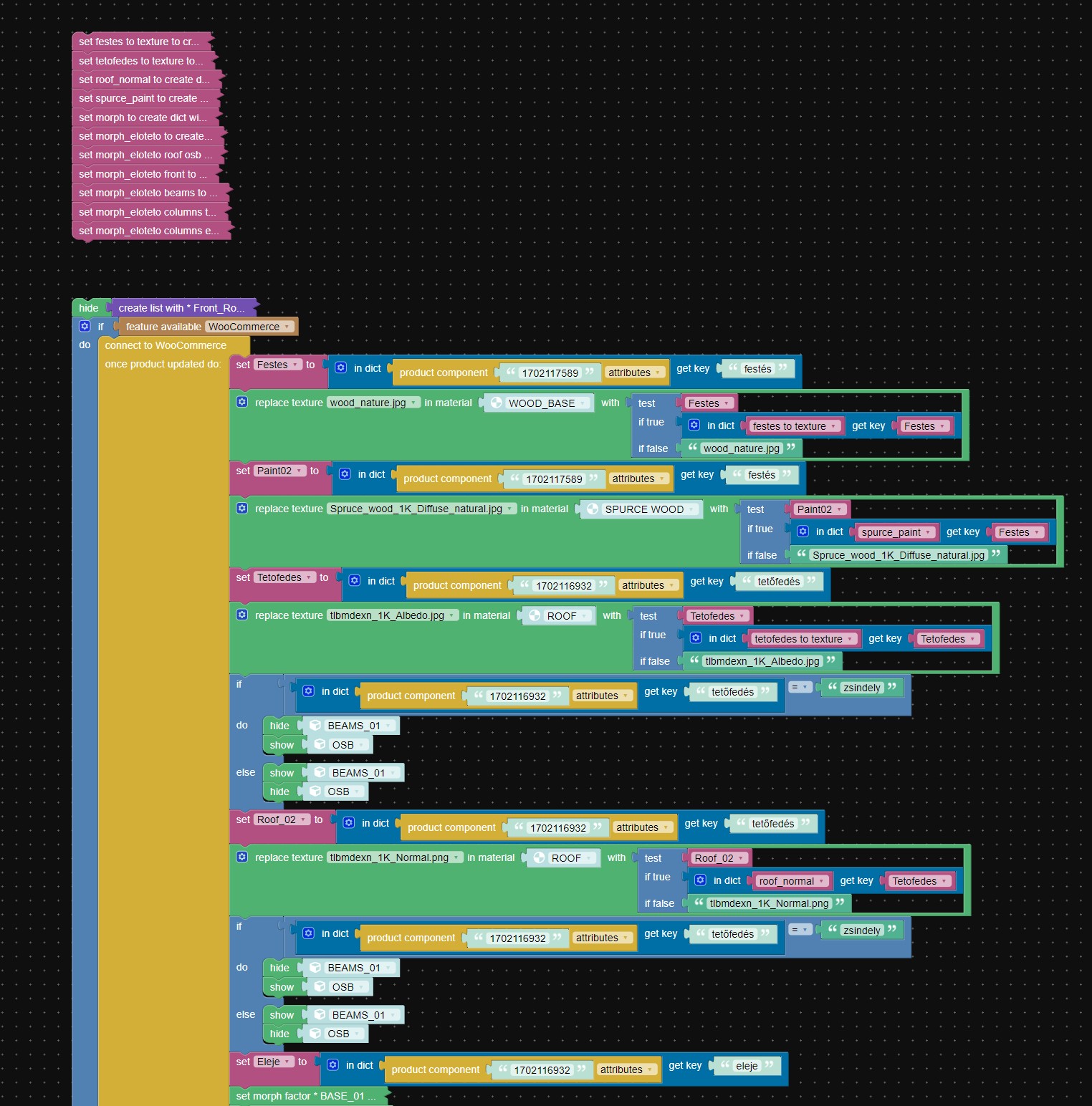

I’m looking for a better solution for handling a complex configurator in WooCommerce with the Composite Plugin. I currently use the “simple configurator” example, but I have 10+ components, each with many variations. As a result, the response time is quite slow—around 2 seconds or more. My goal is to make every option selectable within 1 second. I know it’s possible with custom scripts, but I’d prefer to rely mostly on Verge3D and minimize the use of custom JavaScript.

I’m unsure because I need everything a customer can select. Perhaps we could load items only when they’re actually selected, if it’s possible somehow. By the way, the textures are super optimized and use very minimal data.
2024-10-07 at 5:41 pm #77838kdv
ParticipantAfter changing only one parameter in the configurator your logic performs actions for all possible parameters. Even of you change only one morphing factor your logic will replace three textures and everything below.
2024-10-07 at 6:43 pm #77839peet
CustomerWhy is it working like this? Is it because the puzzles are interconnected? I have no idea.
2024-10-07 at 6:46 pm #77840kdv
ParticipantIt’s because you don’t check what parameters were actually changed. You just apply values for all parameters.

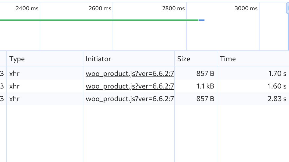

ParticipantTested your app a little closer… actually, the problem is not in the app’s logic. the time between actions and the WooCommerce plugin responses is too long, about 2 seconds. the app itself applies changes rather quickly when it receives responses.
2024-10-08 at 7:06 am #77847
Alexander KovelenovStaffChecked the server response time, looks like this is the main issue (as you said, response delays are about ~2 seconds).
We have a rather low-grade server which powers our sandbox.soft8soft.com, but the response time is about 200 milliseconds (10 times lower). So perhaps you need more powerful WordPress server. Also try to minimize the amount of WordPress plugins used – in most cases it’s the major factor affecting server performance.
