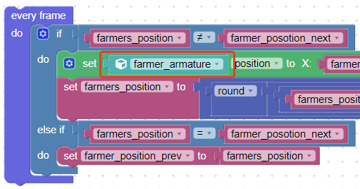

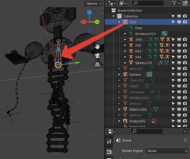

ParticipantSkinned meshes are attached to their armatures. You should move/rotate the root bone to move the skinned mesh. Other meshes (non-skinned) also should be parented to that root bone to move together.
