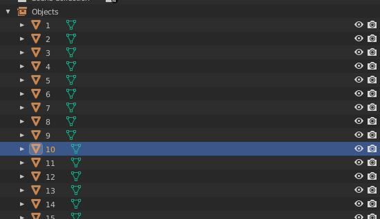

    Screenshots attached. Using latest version, with Blender.
    I have a Blender project with objects numbered 1-72.

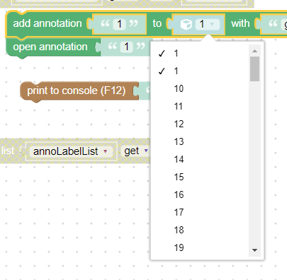

    When I export the gltf and open in Verge3D, the Object selector puzzle dropdown shows two object entries in the list for an object “1”.
    At first I thought it was mixing up 1 and 10 and interpreting the 0 incorrectly and making a duplicate, but after further investigation it is just object 1 that’s causing the problem.
    This duplicate of #1 is also breaking any puzzles that reference object 1.

    This behavior appears to be OK. In the “add annotation” puzzle you create a second object named “1” and it appears along with the original “1” in the object selection dialog.
    P.S: Perhaps we need some option to rename the annotation after it’s been created :scratch:
