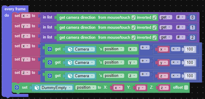

Would like to keep the HTML Embed at 50% width but be able to track across the entire width and height of the page. I’ve also attached my current puzzle that I got from
https://www.soft8soft.com/docs/manual/en/puzzles/Camera.html#get_camera_direction
Sorry for the rudimentary question as I’ve little experience with code. Hope anyone would be able to help, really appreciated, thanks!Attachments:

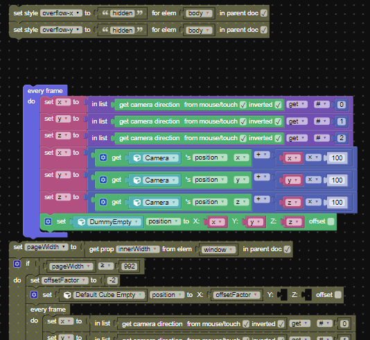

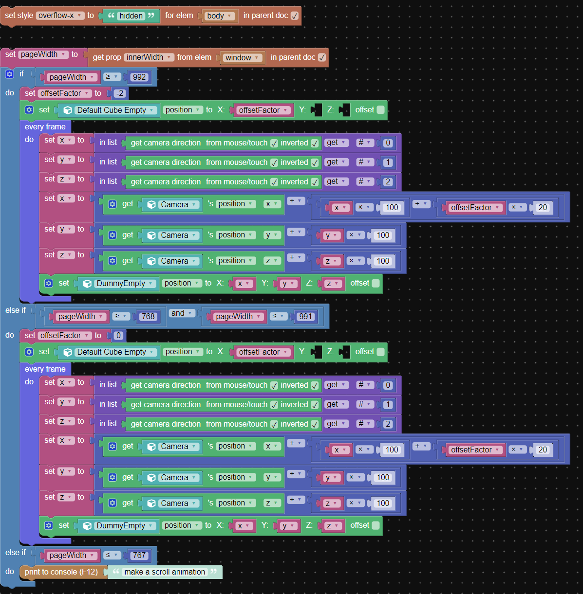

I’m using
https://cdn.soft8soft.com/AROAJSY2GOEHMOFUVPIOE:4821bbbc03/mousetrack/mousetrack.html for the test file.Have been trying to work around the left alignment by offsetting the default cube according to different screen widths as attached below.

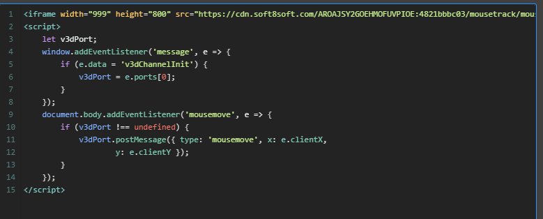

You need to paste the following code sample into the Embed Code Editor in Webflow:
<iframe width="999" height="800" src="https://cdn.soft8soft.com/AROAJSY2GOEHMOFUVPIOE:4821bbbc03/mousetrack/mousetrack.html"></iframe> <script> let v3dPort; window.addEventListener('message', e => { if (e.data = 'v3dChannelInit') { v3dPort = e.ports[0]; } }); document.body.addEventListener('mousemove', e => { if (v3dPort !== undefined) { v3dPort.postMessage({ type: 'mousemove', x: e.clientX, y: e.clientY }); } }); </script>– you can notice that the iframe doesn’t need “id” anymore.

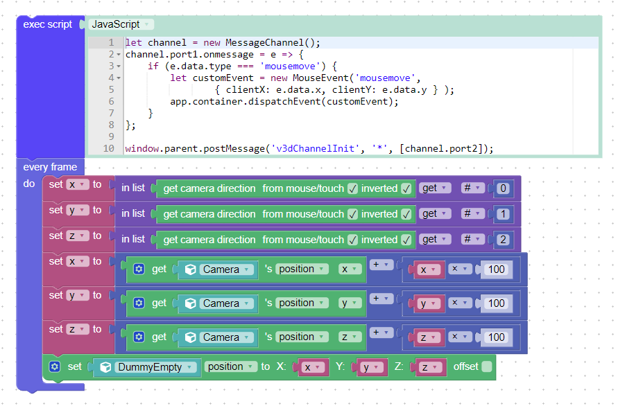

let channel = new MessageChannel(); channel.port1.onmessage = e => { if (e.data.type === 'mousemove') { let customEvent = new MouseEvent('mousemove', { clientX: e.data.x, clientY: e.data.y } ); app.container.dispatchEvent(customEvent); } }; window.parent.postMessage('v3dChannelInit', '*', [channel.port2]);– you can do that in the Puzzles Editor via the “exec script” puzzle like this:
This way both the main page and the iframe window can interact with each other.

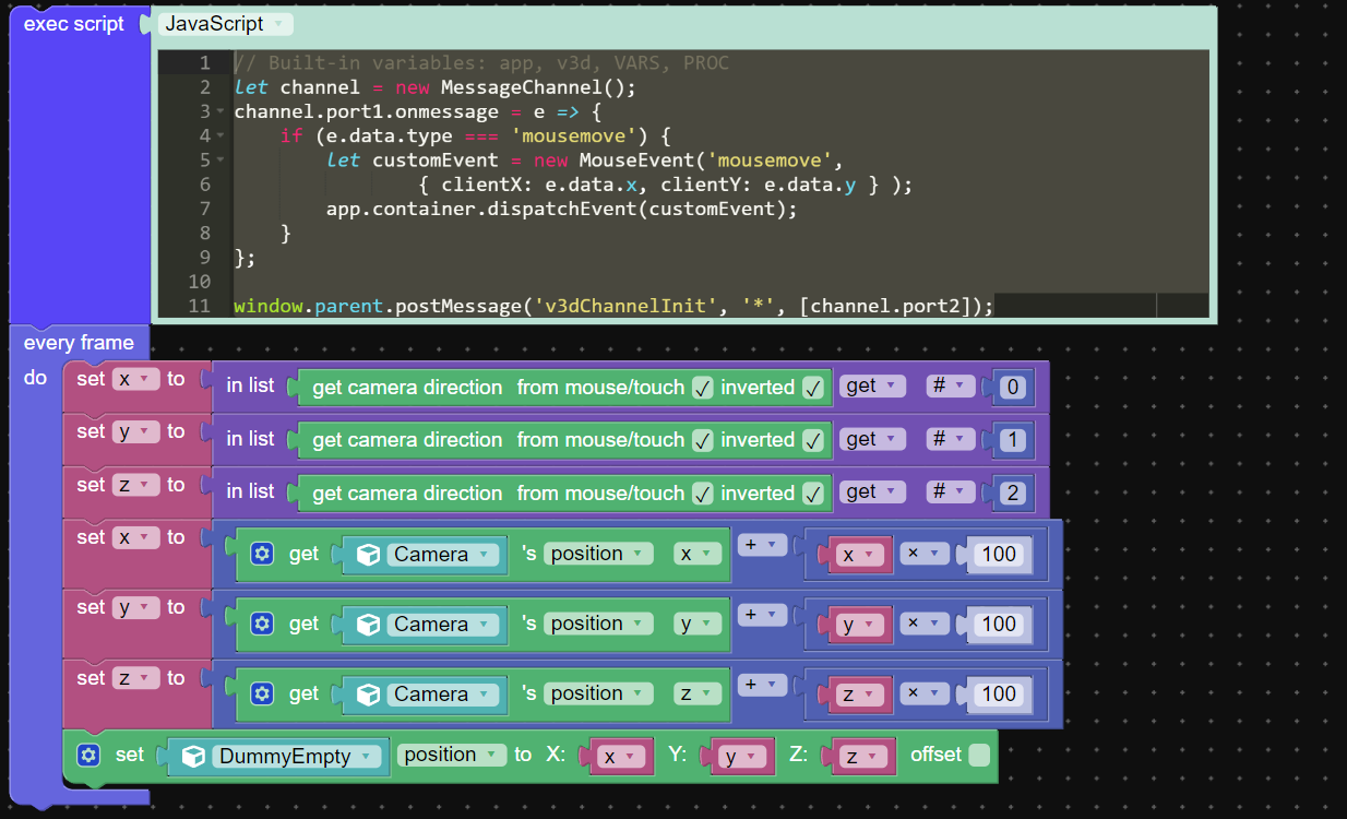

2022-05-06 at 10:16 am #51745Jonathan Wan
CustomerHi, as seen from the video below, the defaultCube tracks the mouse correctly on the page for the first 1 to 2 seconds after the iframe has been loaded but stops afterward, I’ve tried recreating another mousetrack application but get the same result as shown below. Do let me know if it’s solvable.
I really appreciate the amount of help, thank you.
