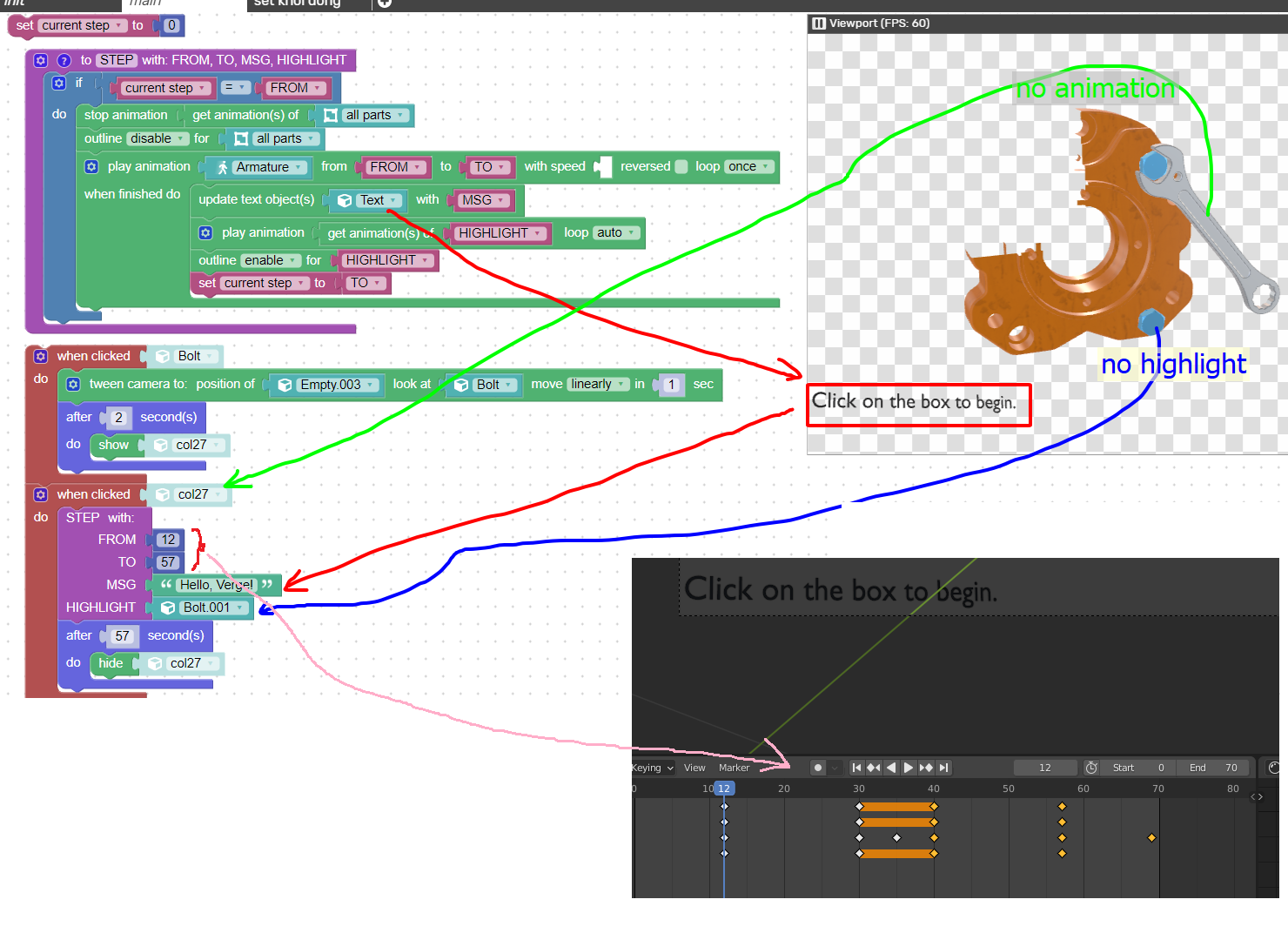

Currently, I have a problem when I use HIGHLIGHT function ( in the E-learning example)
However, I can’t use this function also FROM, TO function

Mikhail LuzyaninStaffI cant see any material animation on the object. At first you need to animate the highlighting in the material then run this animation using puzzles.

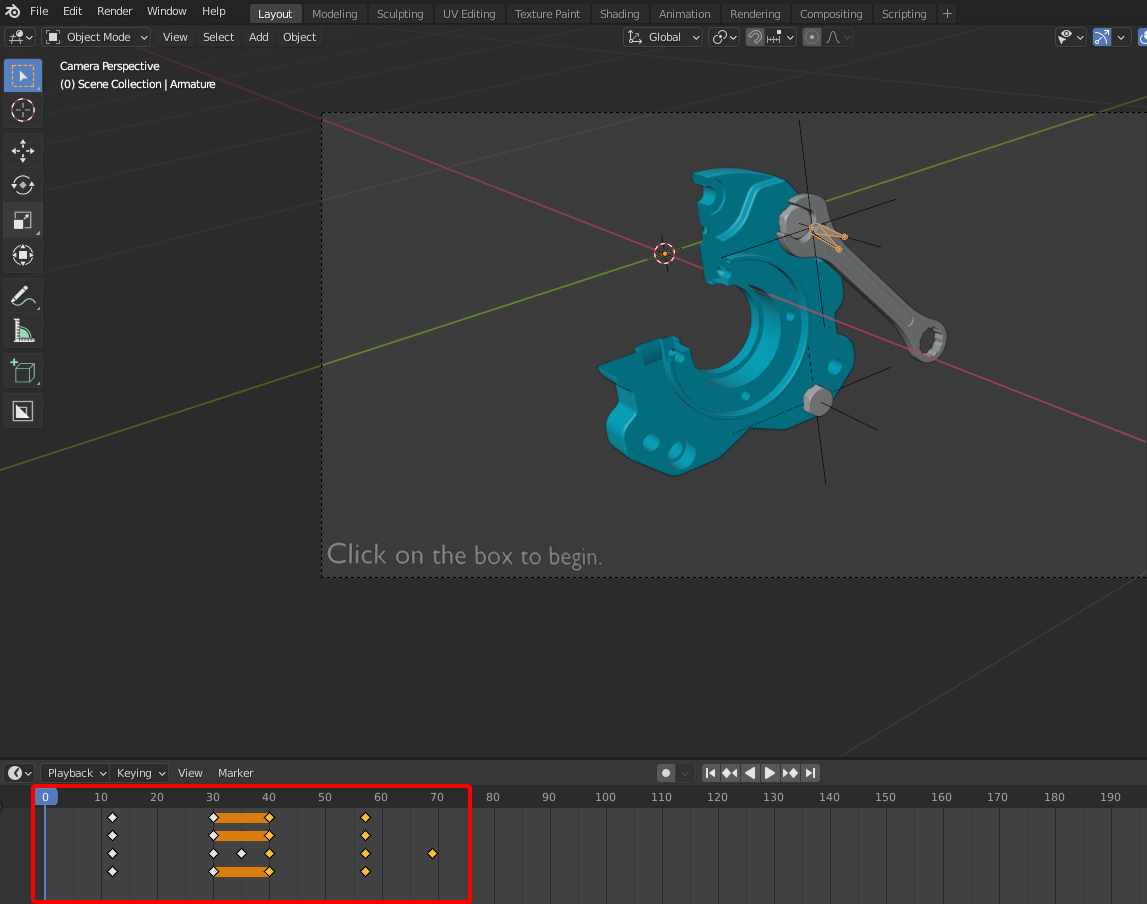

my file already has animationAttachments:
2021-05-21 at 9:04 am #41210
Mikhail LuzyaninStaffOr you made it directly on the shader but you need to animate RGB node and connect it to the material instead.

Why FROM and To function don’t work when animation armature

Mikhail LuzyaninStaffWhy FROM and To function don’t work when animation armature
Armature not included in all parts group, you also need to set 0 keyframe so all animation will be synchronized.
