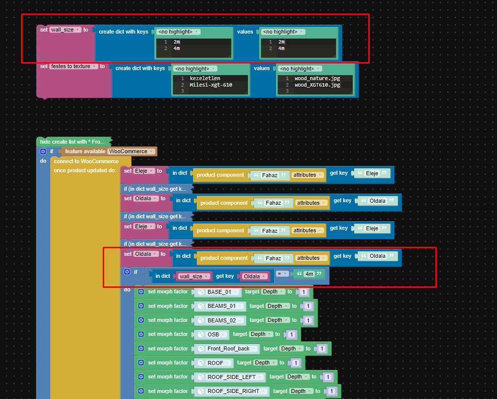

    Hello everyone!

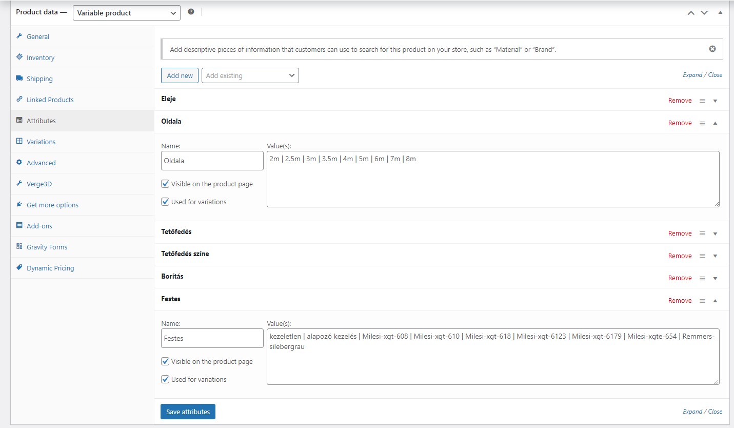

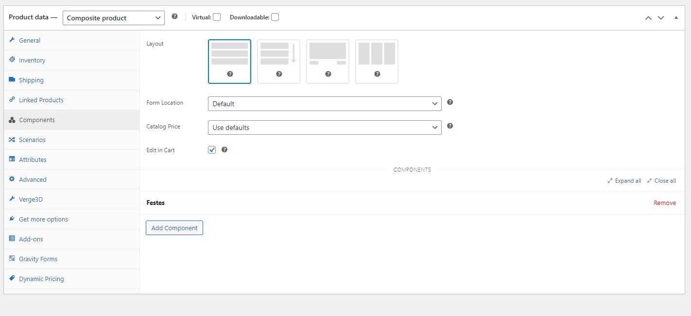

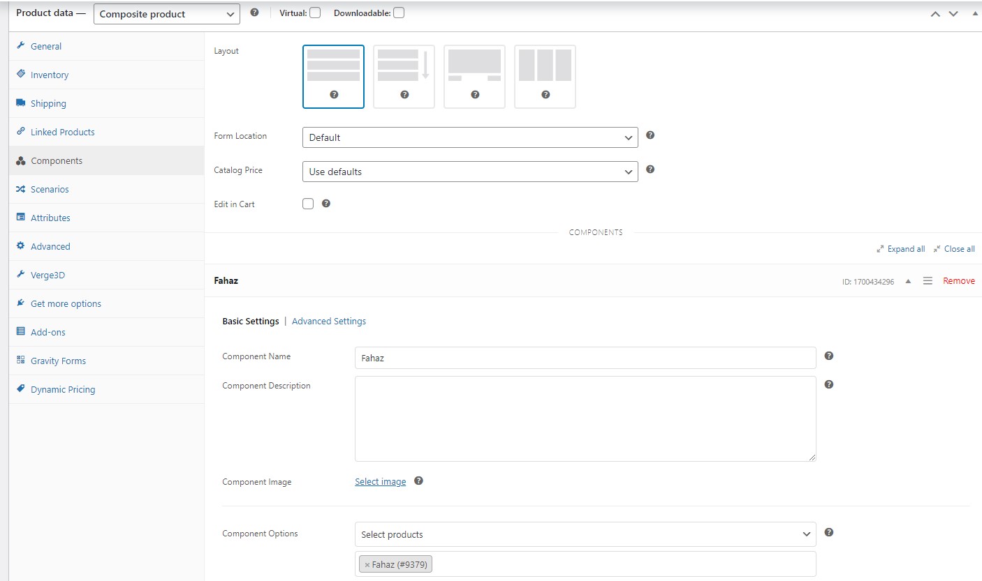

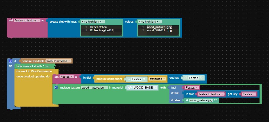

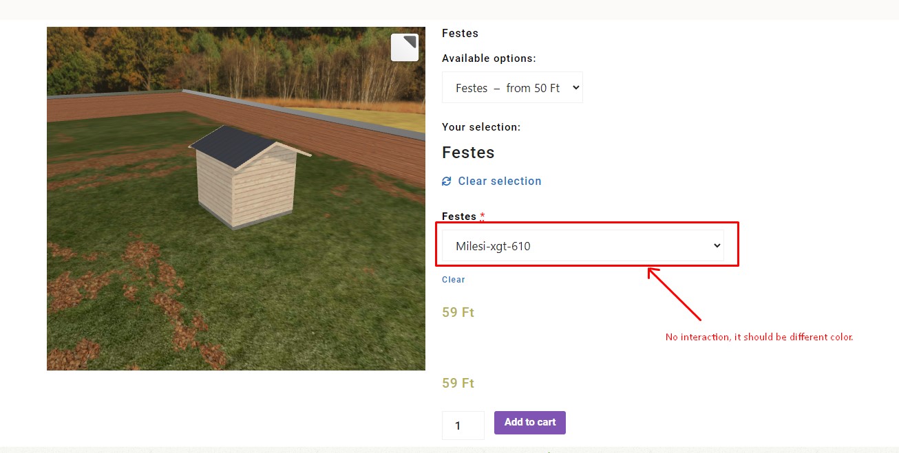

    I’ve tested the new “product component” feature on my old configurator but without success. As you can see in the attached screenshots, I tried two composite options. One of them is identical to the “Drawer” demo in the asset store, but it’s not working for me. Does anyone have any ideas about what might be going wrong? :scratch:
    Here you can check the live test ( just a rough test site): https://3dkonfigurator.hu/termek/new-konfigurator/

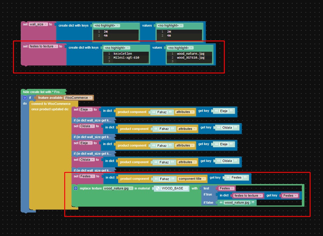

    *on the “texture” screenshot I have left the component puzzle on “component title” but I have tried with “attributes” as well, same.
    Thanks a lot for your answers!
    Best regard,
    Peter

    Hello everyone!
    I conducted some tests again today, but I still can’t get the simple texture change to work with the composite plugin. I’ve cleared the cache and disabled other plugins, but it hasn’t helped. If anyone has any ideas, please let me know. I was thrilled with this new feature and I really want to use it. I apologize for my impatience.
    Thank you in advance!
    Best regards,
    Peter

    Hello everyone!
    I have re-exported the “gltf” file from Blender and created a new Verge3D application to build this test configurator from scratch. I’ve configured everything identically to the “drawer” demo, as shown in the screenshots. I’ve also uploaded this drawer demo to my test site, which works perfectly. However, my app doesn’t work and I’m unsure why.
    I would greatly appreciate if someone from the development team could take a look at this. I need to update my client regarding the feasibility of continuing with this product.
    Best regards,
    Peter
