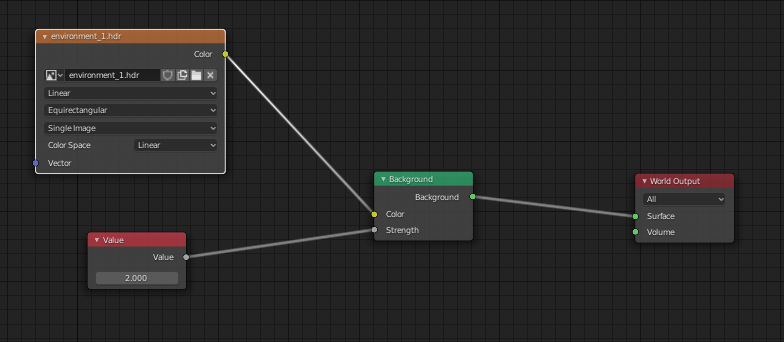

    I am just trying out puzzles, and like them so far. I’m trying to figure out how I can interactively change the world power when clicking on an object. The project is an outdoor LED lamp. The idea being that the main HDR light dims and glow is enabled making the LED’s appear lit. (Any suggestions to accomplish this in a different way is welcome.
    So far, I have tried using ‘When Clicked’ with ‘Set Value > in Material’ as well as Bloom.
    I have no real troubles with Bloom, but when I load the Environment material, I do not understand how to define the value I want to change. It claims there are no values.

    You need to connect a Value node in Blender before.
