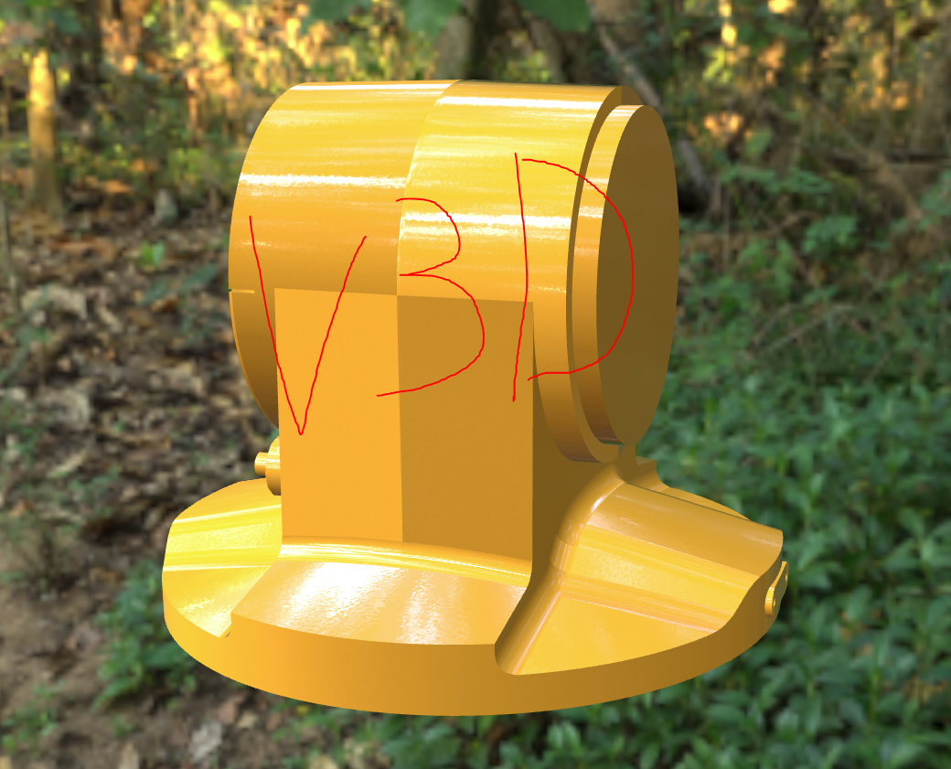

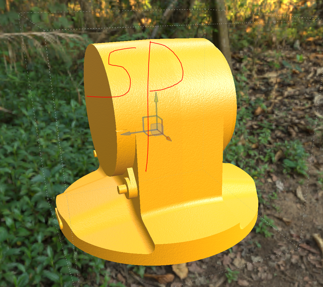

    barman126
    in sp is very well
    but in v3d looks like so bad
    anybody help me TKS

    Seems like something wrong with normals, try to normalize them.

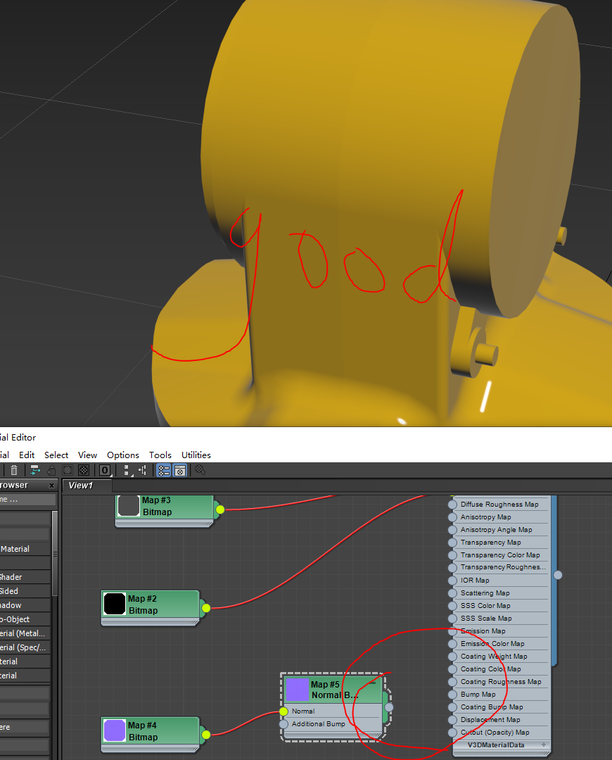

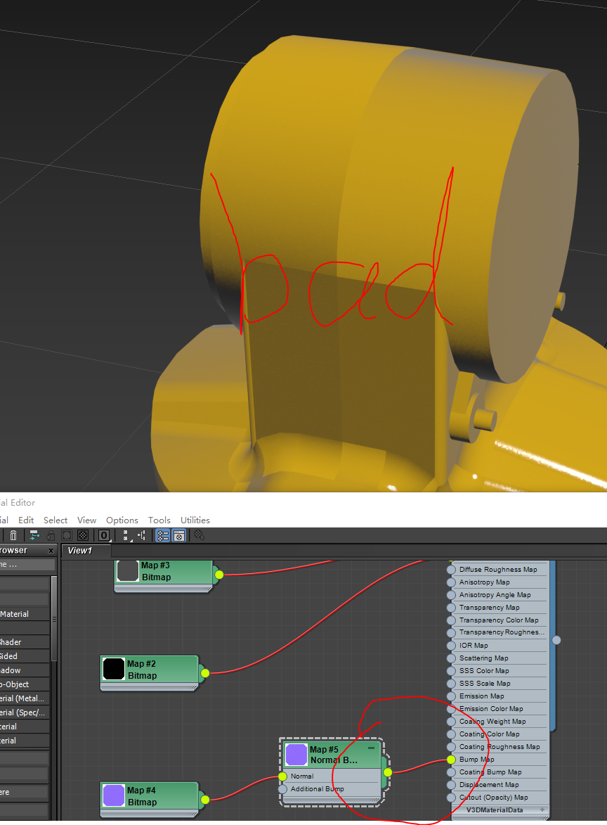

    barman126
    like video correct problem still here
    don’t use normal’s map problem disappear

    Yes, then the problem in uvmap you need to re-unwrap thet part of the model that have the issue.
