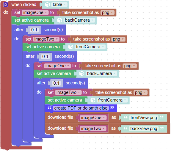

    I am trying to take two screenshots from two different cameras. My puzzles screenshot is in attachment. Please have a look and let me if i am doing it right or not. With this puzzle, my first screenshot is by default camera and remaining two screenshots are all black. I have only two cameras.
    #37257
    Try to set a delay between changing a cameras.

    Hi! I’m having the same issue. Is there a different way to take multiple screenshots at once? When I set a delay, it must be quite big, so the camera will have a chance to change position on the slower devices. And eventually, it takes a really long time for the user. Is there any chance to take multiple screenshots at the same time? Important thing: those screenshots will be later used in a PDF generated thanks to CyberFox’s plugin.
    #54985
    Nope. You definitely need to switch between cameras and it takes some time to renew canvas. Thus you need a delay. It can be a small delay but it must be.
    Works with no problems.
    https://v3d.net/a6h
