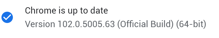

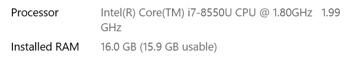

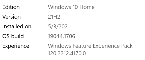

    mbhladilek
    I installed the latest version of Verge3D. Still does not export morph animation to gltf.
    I’m starting to grasp for straws now so I uploaded images of my system device, windows and chrome current status.
    I reuploaded the test01 web page for your inspection.
    https://v3d.net/835
    I hope this helps, I really need this to work.
