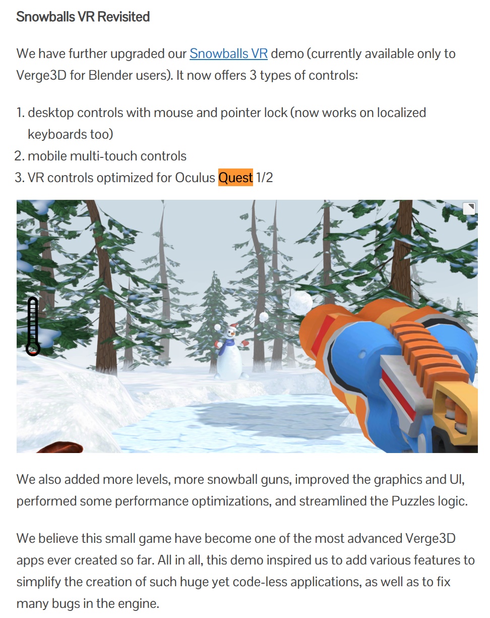

    Is there any special settings or procedure to publish the VR content through verge 4.5 for Oculus quest series ?
    Can anyone elaborate what & how ?
    In search I just found one article it nothing else. see image
